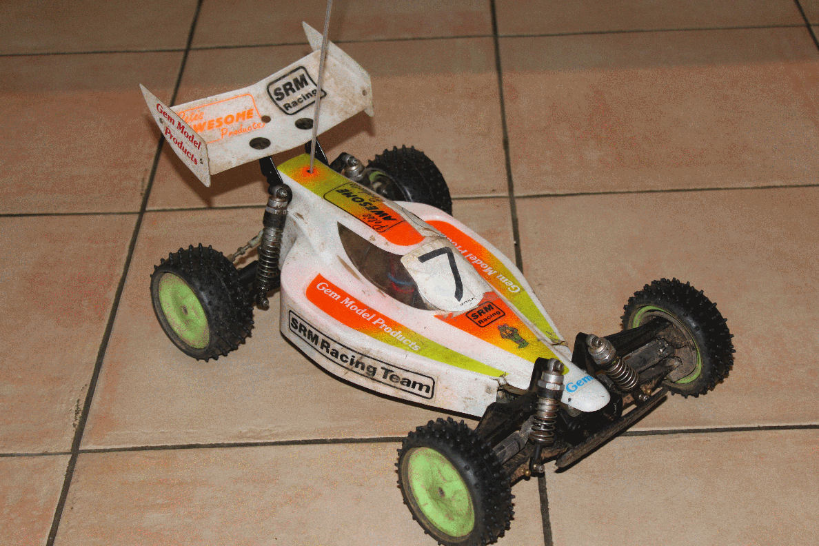

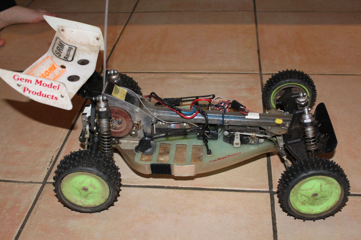

I have my original ProCAT converted to a brushless & Lipo runner now, but its pictured here as it was when I dug it out of the loft, complete with dirt from its last event in Taunton in 1990. I almost didn't want to clean it up!

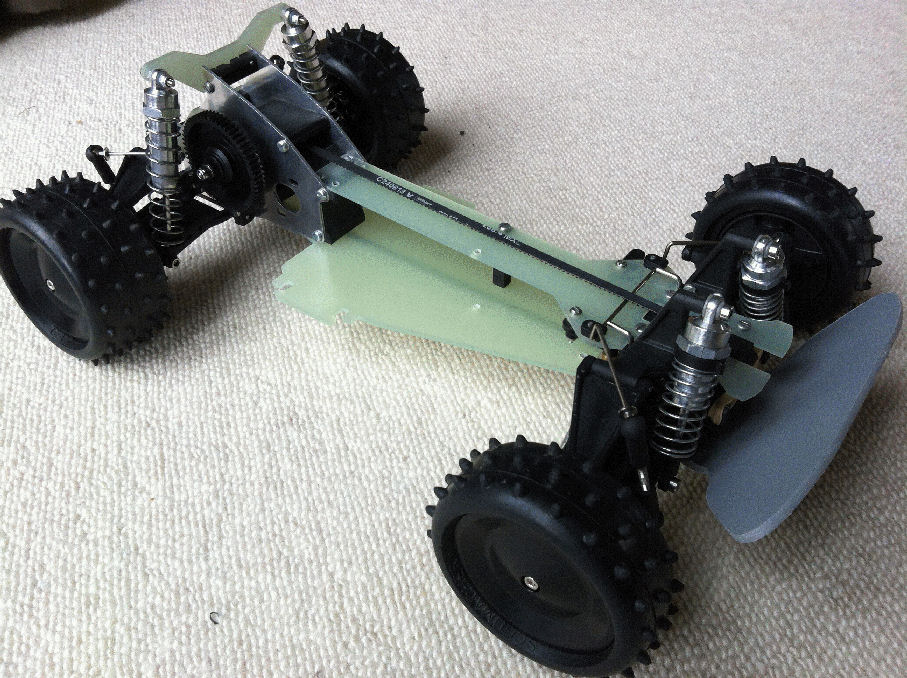

More recently I have restored my CAT SWB, with probably 90% new parts, as you can see its pretty mint now.

It´s hard not to like the SWB, even when beating the c... out of my MID.
Very clean example You´ve got.

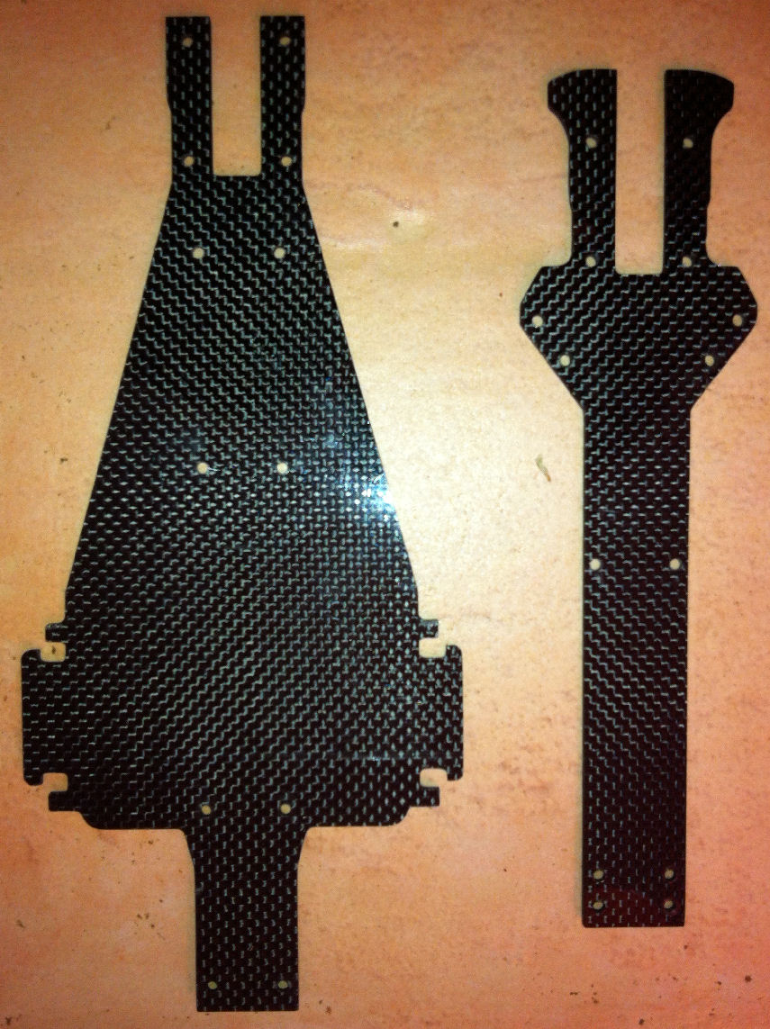

Here's the Tanaplan chassis set.
Not sure whether to use this for a ProCAT build or if the standard chassis would be more sought after?

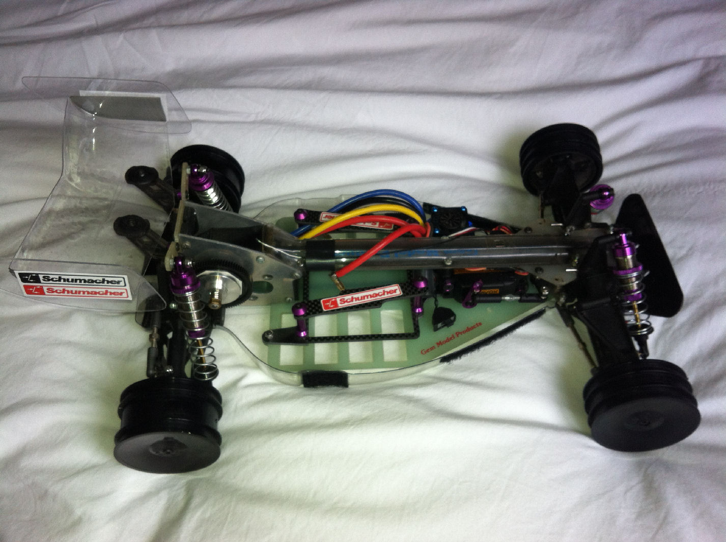

Here's my old racer ProCAT in its current form.
It runs an 8.5 brushless motor, with saddle lipos.
Saddle nests are from a Schumacher SV2 with some custom carbon mounts to avoid needing to drill the standard chassis.
I've also made a custom slipper which uses an SV2 spur and slipper pads on a shaft from an original period Schumacher slipper.
I've made carbon, ballraced steering arms for it and its currently got more modern CAT SX shocks on it.
It goes very well, hope to run it against Derbydans ProCAT at Silverstone soon!
(Let me know when you're bringing yours out to play Dan?)

Hi Nigel.... good to see your vintage Schumachers over here on RC10Talk... I love the shots of your ProCat in period trim (& period mud )

I've carefully set aside all the period bits so it can go back as it was, but that mud is gone forever!DerbyDan wrote:Hi Nigel.... good to see your vintage Schumachers over here on RC10Talk... I love the shots of your ProCat in period trim (& period mud )

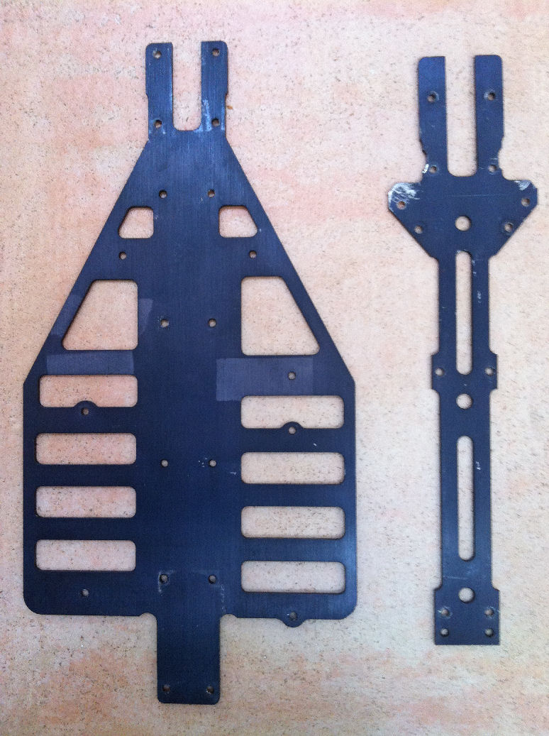

So, here is my Fibrelyte Short Wheelbase Chassis and top deck.
Starting to think about building a runner SWB CAT with a modern twist, kind of the evil twin to my mint standard SWB!
