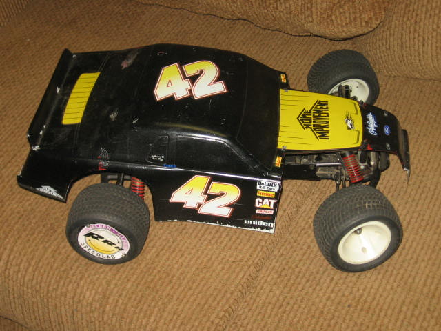

Re: My RC10T's Pushing
I did some of what you guys said and it helped out a lot and for that I am verry greatfull, however I need RUBBER!!!!! Here is a pic from earlier.
