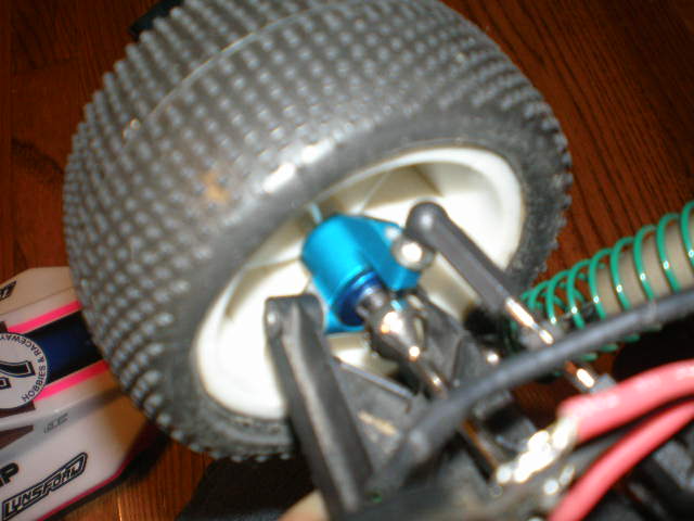

Nice ride. What rear alum. hubs are those? Are you running them with the b4 axel and the spacer on the inside?
markt311
Posts: 1037
Location: nashville TN
Re: My weekly racer (updated 11/4)
Post by markt311 »
m_vice wrote:Nice ride. What rear alum. hubs are those? Are you running them with the b4 axel and the spacer on the inside?
They're Losi XXX hubs that Charlie don't surf machined down to fit rc10 arms, I'm using B4 cvd axles with rc10 bones. Right now I have to put all the spacers and the blue washer on the inside. It works out ok but I'm going to get some B4 bones so I can move the washer to the out side. There's a lot more plunge at the outdrive because the pivot point has been changed.
I'll get to see what it will do on the track Saturday.
Mark

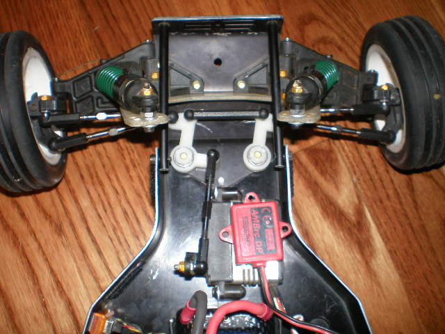

And I put T4 front axles up front. The GT wide axles I had on there were just too long.
