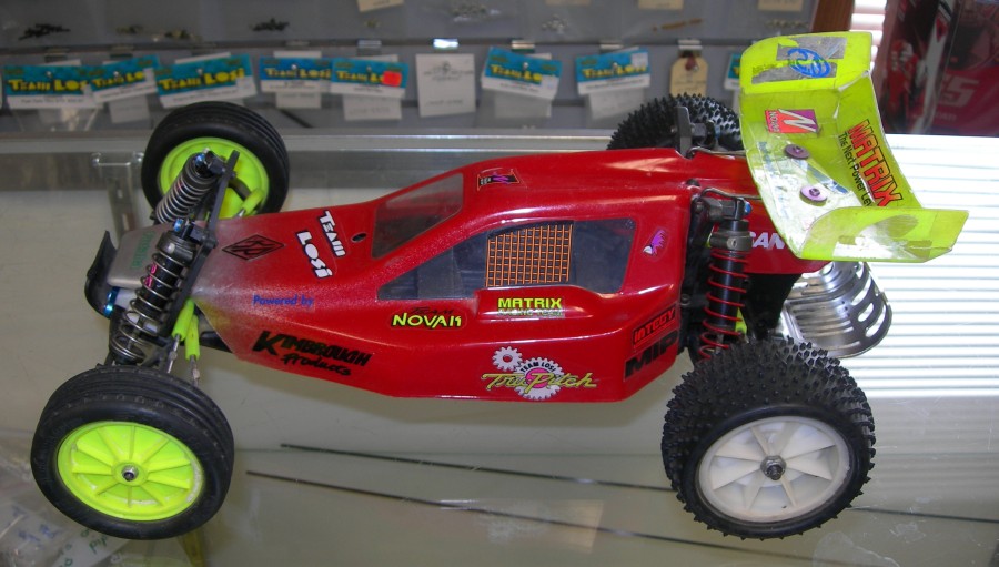

DerbyDan wrote:*5 This was my XX back in the day - it was upgraded to CR spec & includes Trinity parts & a lightweight motor mount that I got anodised blue, it also has the de-rigure Xcellorator shell to complete the Kinwald clone look 8)
That was a beautiful car! I would have regretted letting that one go as well. What are the distinguishing characteristics of the Xcellorator body? I have an XXCR and an XXCR KE and they both appear to have the same body. Is the red one an Xcellerator as well? Sorry for crappy ebay pictures.
Yeah, they are both Xcellerator shells, it was popular to replace the original kit shell with the Xcellorator, it was much easier to mount it over the rear end. There is also a Jammin shell that looks almost identical but has an indent on the front 'bonnet'.
