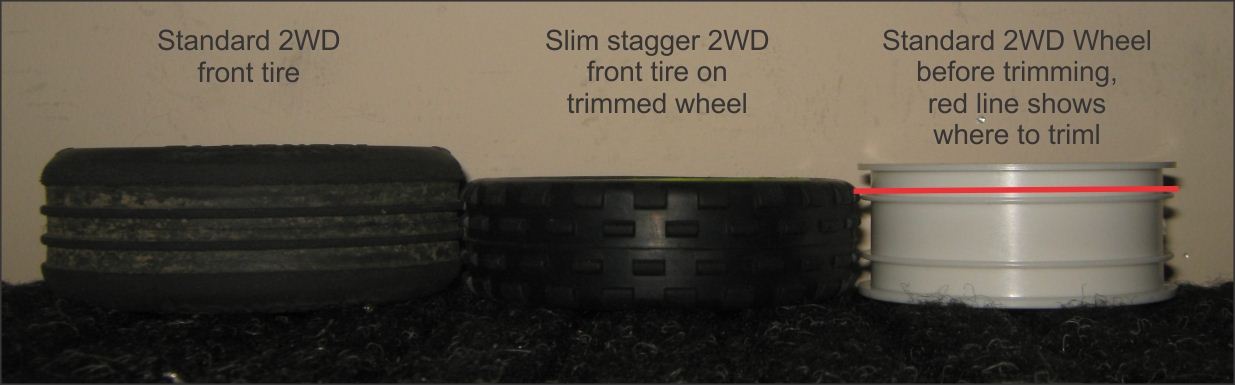

They're slimmer than 2wd front rims, so you can either trim off the wheels inner bead-thingy, or just let the rim stick out of the inner bead of the tire.

Here's a visual of how/where you want to trim your wheels for Schumacher's 2WD slim staggers.
