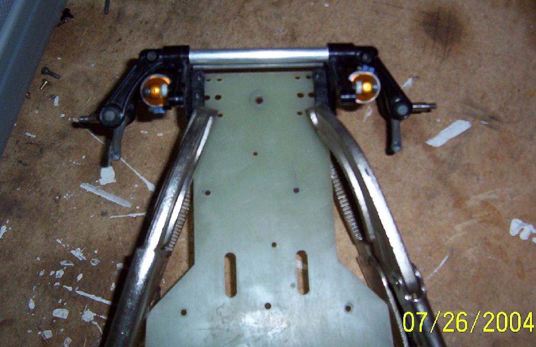

Ask and you shall receive..
This is an old photo I had the illustrates how I set up the front end to mark a new set of holes.
- Brian -
