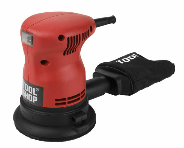

For the chassis, I used a random orbital sander. You have to be really careful because it doesn't take much to put a deep gouge in the chassis. I used a medium and gradually finished with a fine grade of paper.
After the sanding, there were very fine scratches and the aluminum feels bare. I then used the green side of the sponge, laundry soap and cold water to lightly clean and "even out" the surface.
You'll notice all of the black oxidation and sanding residue washing off. The finished result feels very smooth and the color is very even.
For the plastic parts, I used different grades of sand paper and good old elbow grease. I've tried using a mechanical sander, but the heat melts the parts. For a brief second, I thought of sanding this under water...but Traxxas doesn't make a waterproof sander
With the plastic parts, the important thing is to take your time, use a lot of water and soap and the finest grade of sand paper as possible.
