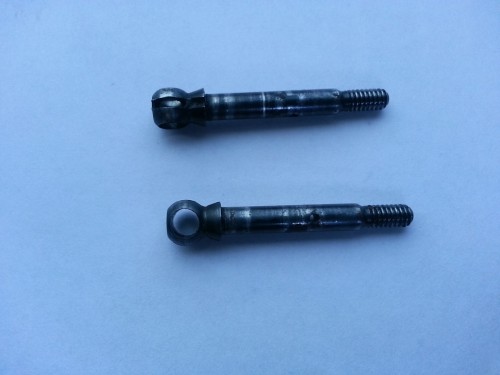

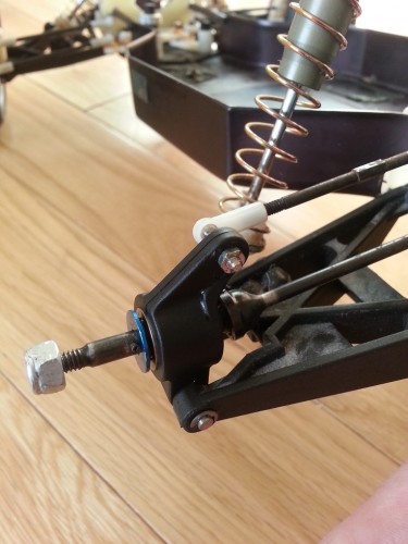

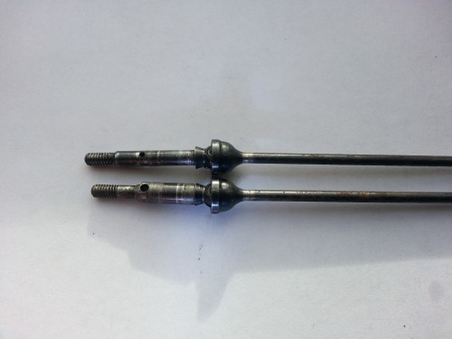

I was just about to press the button on some T2 CVD`s when I lucked out and found these 3/16" axels in my parts box....never had a T2 so I guess they must be from a B2 that I had???
I used the rest of the parts from the Gas Truck CVD`s
Then the RPM carriers, bearings and B4 spacers....parts bin special but works great! thanks for all the help
