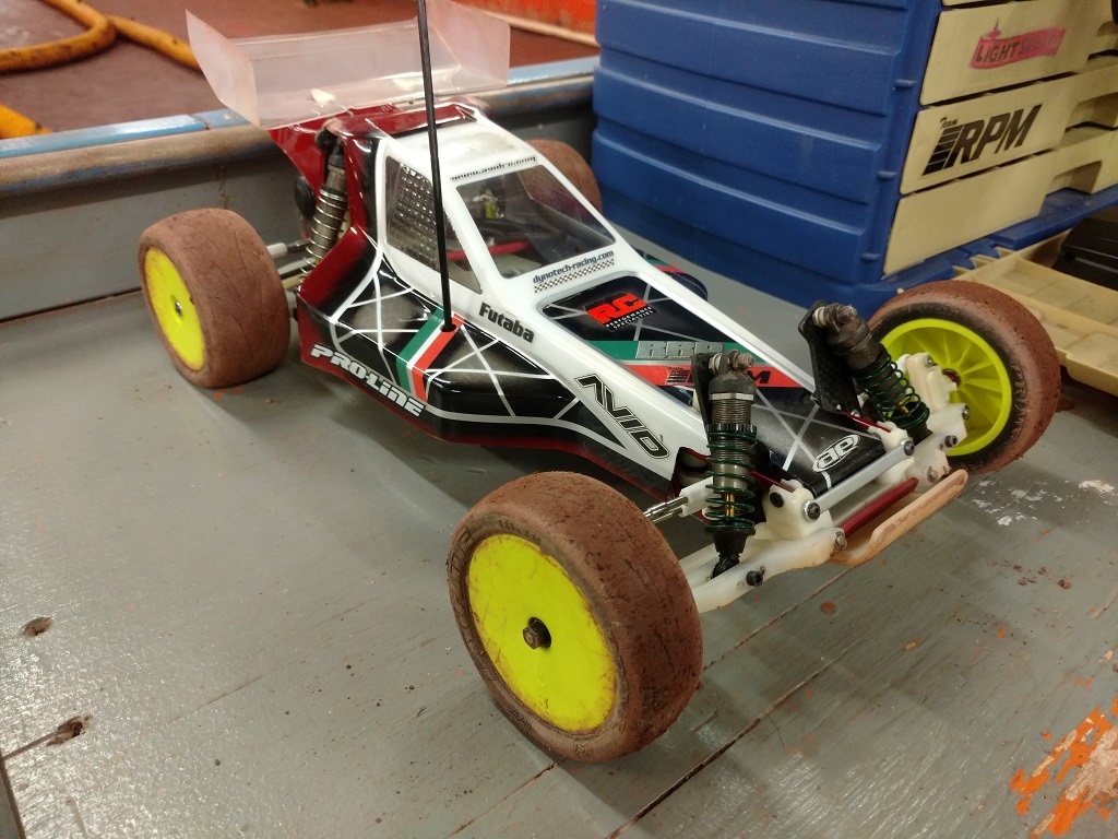

Right now, I'm just trying to soften the car up slowly. It just feels like it's on top of the track. Now a lot of it could be tires. I'm running green compound Jconcepts Octangons, but the tire of choice there seems to be m4 Proline Primes. I don't have the extra money to spend on tires right now, so I play with what I have a lot of........ oil, pistons and springs. :wink:
Another thing i haven't messed with yet is battery position. Running shorty lipos so there is plenty of room for adjustments.

Another little update.
Got a set of M4 Proline Primes for this. Seems to be what everyone runs at the track we go to. The car is still working pretty well, I'm fairly happy with it. Current shock setup:
Front - 32.5 oil / #1 pistons / green springs
Rear - 32.5 oil / #2 pistons / silver springs
