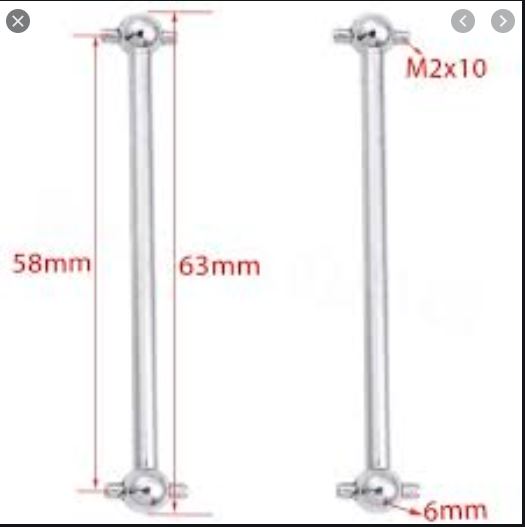

I have used 02003 HSP dogbones as replacement. The length is just about right, and they are much easier to find.

The 02003 is slightly shorter pin to pin than 6370 (55mm vs 57.25mm) and the pins are slightly smaller (2mm vs 2.38mm ) but it's certainly close enough. The ball diameter is about spot on.
Also, they sell a 08061 that's 3mm longer than 02003. And they're cheap as chips on ebay. That's awesome! Thank you for posting this info, I've learned something useful today.
