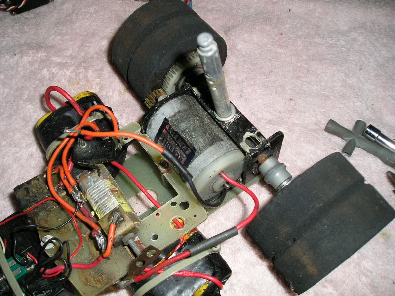

No pics on an RC10 but here's one "installed" on a 1/12th car:
:shock:
The ones I've usually seen and removed were an ugly mess of poor soldering and a rat's nest of wiring...
Of course ymmv...

Thanks for the pic. That one has a micro switch ,which I original had way back when .This Parma setup doesn't have that. I 'd rather have the microswitch setup ,but I forgot how I put it in. Thanks.

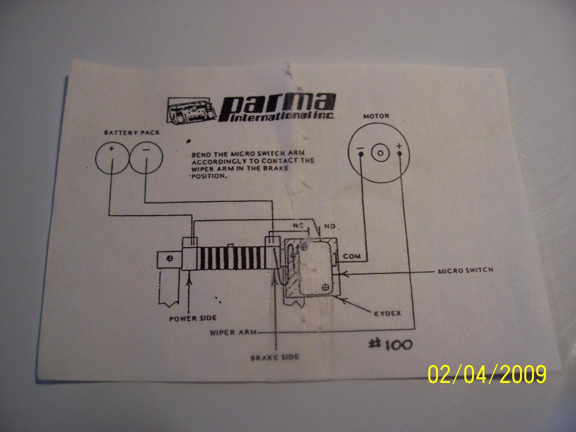

I have new parma reverse switch that I have had for years just never mounted it . Hope this pic will help. Just mount the kydex to the speed control them mount the switch bend the arm as shown i pics to contact the wiper arm. Wire up as the pics say good luck I hope this helps you out.
PTModIT
Posts: 67
Joined: Tue Dec 23, 2008 2:24 am
Location: Fort Erie,Ontario.
Re: Parma Reverse Kit.
Post by PTModIT »
Now thats bring back memories of how I did it. Thanks.
