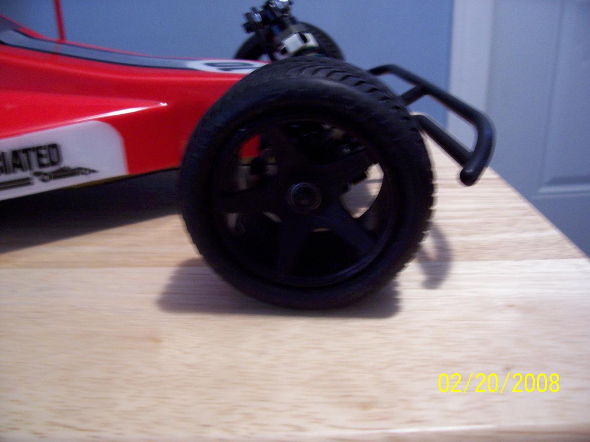

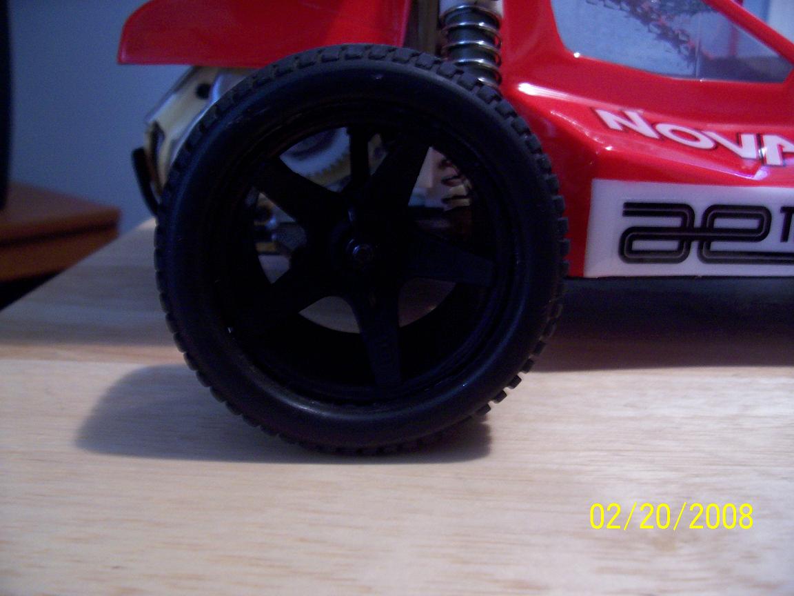

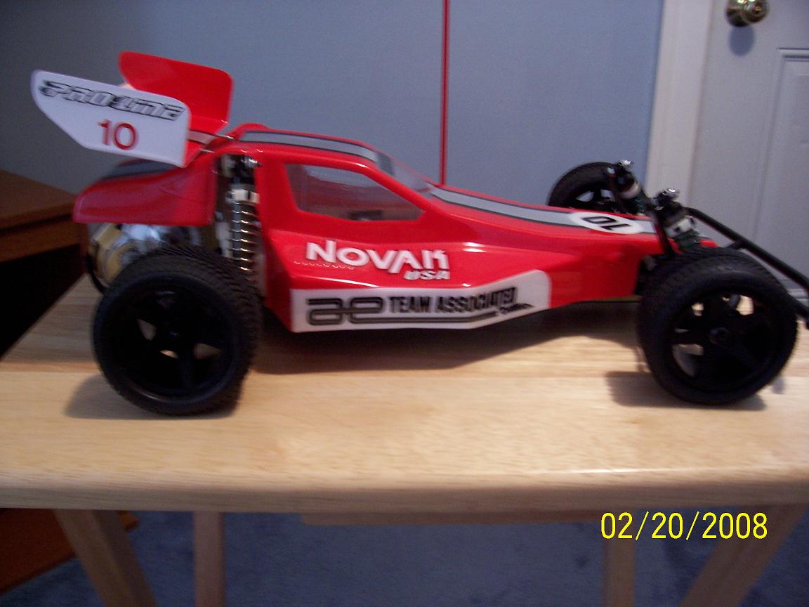

If you like the gold keep them as they are . If not I used caustic soda to strip mine but be carefull caustic soda is nasty stuff. I found the caustic soda at home depot just mix some up with water it dosn't take much and let the soda work on the rims it doesn't take long for the plating to come off.Pull em out a couple of times and use a old tooth brush and go over them until you get all the plating off. Like I say NASTY STUFF make sure you DON'T REUSE the container OR THE BRUSH that you used for stripping just trash it!!. After you strip the rims you can dye them . I used black rit dye on my rims look at the pics . Once again make sure you TRASH the container AND THE BRUSH that you used for stripping . USE RUBBER GLOVES an just keep a eye out on whats going on .Maybe someone will post some other ways to strip the plating this is just what I have found that so far works the best for me. I have have used oven cleaner and other strippers but they all have caustic soda in them .
