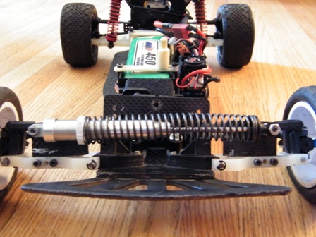

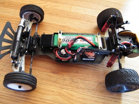

Here is my graphite RC10 with:
Klein Arms
Mono Shock off of a truck (unknown model)
B4 CVA's
RC10t hub carriers
Extended front wheel shafts
TLR 22 Losi steering rack-this allowed me to squeeze more weight up front to balance out the car better
LIPO
Castle 4600 4 pole
Hobbywing programmable esc
Prior to the mono shock, I had set the local track record for fastest lap time. I hope to test out the newly added mono shock. First without sway bar (as is right now) then with sway bar.
Klein Arms
B4 CVA's
RC10t hub carriers
LIPO
Castle 4600 4 pole
- Attachments
- rc10 mono shock front view_small file.jpg (73.39 KiB) Viewed 1144 times
- Note TLR losi steering rack
- rc10 mono shock whole car_small file.jpg (76.8 KiB) Viewed 1144 times
Re: MIP Mono Shock Conversion Anybody got any pictures?
Oh yeah, got sick of the wire wing popping off so I added B4 wing mounts....
RPM ball cups
titanium 4-40 rods
TOTAL CAR WEIGHT IS 3.49 lbs.
RPM ball cups
titanium 4-40 rods

I wonder how this would work with torsion type springs on the arms themselves and the shock with no spring (or a very light one)...should stop the "rocking" of the front end.
--Joey --
Vintage A&L and Factory Works
JKRacingRC.com
JKRacingRC.com
What I setup here maxes out the arm travel so it's at full extension, all the time. I don't think it will rock as long as the spring tension is constant and of long enough range of motion.
I will see how it runs tomorrow and then possibly add a sway bar kit.....

Joey, are you thinking of a sway bar? I think that might work.
I ordered one for a T4 which I can hopefully fit. It was $6 on ebay with hardware and different tension bars....
not a traditional sway bar, more like one on steriodsadam lancia wrote:Joey, are you thinking of a sway bar? I think that might work.
think of a mono leaf spring attached in the center of the bulkhead area (i guess that isnt torsion style now that i picture it)
front mono in this execution (and the mip one, same as fox/boomerang) is doomed to fail because the spring transmits the effort right to the other side, but in the other direction (it acts like a rollbar, as opposed to an anti-roll one!)... The only way to prevent rocking is some serious swaybar diameter, but then it means the suspension becomes rock hard when sollicitated independently. You "can" have the spring already compressed at full extension to minimize the rocking at "idle" but then there's no more downtravel and handling will be crap anyway
As someone said earlier: "Even tamiya dropped it"
Paul
Paul
when you add a 3rd mono to a set of two indie shock dampers, you create an anti-squat/pitch device... F1's use it.Jedi Master wrote:Looks like they would be simply to make from some fibre-glass, plasticard or carbon sheet. Wonder how a buggy would run with a mono shock fitted in addition to the standard shocks? Thunder Tiger ran this type of 3-shock set-up on their legendary EK4, (I have X2 BNIB: woop woop!).
Would it act to support the sway bar effect?
Paul
I really appreciate your input on this guys. I does make complete sense that the compressed, outer tire's force will end up pushing the mono shock to fully extend the inner tire, resulting in MORE body roll; BAD! I concur.....
I am going bad to my previous setup where I had two individual shocks canted towards the center which I think was a good compromise in getting a lower CG while having independent control and tension over each control arm.....
Pics coming soon.....
