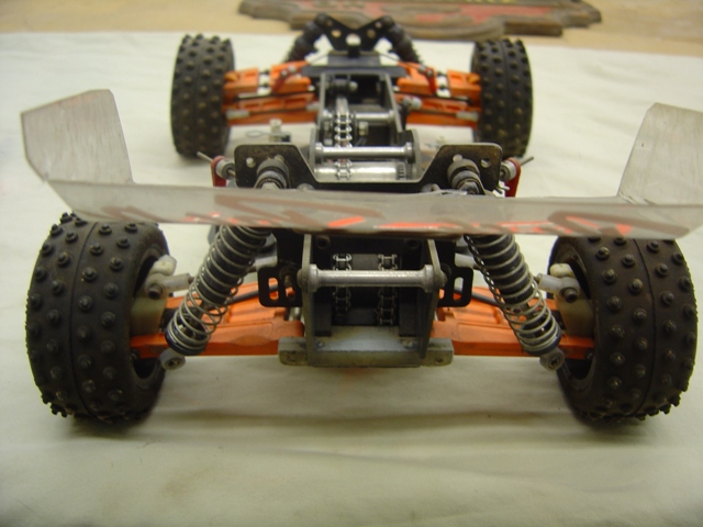

You are not quite finished. I believe there is something amiss with the front tower...

Re: MIKE DUNN PRO RADIANT Replica from the WC 89 in Australi
Can I make a guess? Did the tower used to rock from side to side with a single bolt mounting the plate to the bulk head?Jay Dub wrote:You are not quite finished. I believe there is something amiss with the front tower...

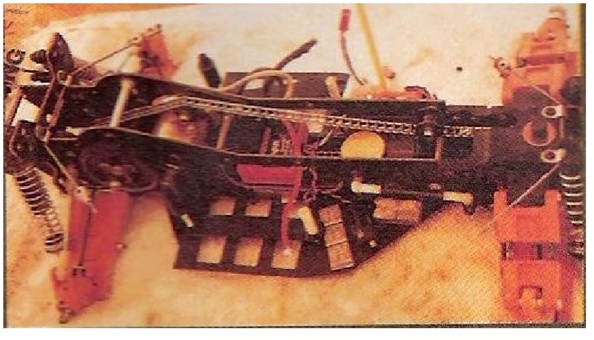

For the front shock tower, I don't know if I use the rocker at the World I have no pics from the front of the car / poor angle ..., maybe Mike or Steve or JHarris can confirmed?
The white rear toe in , miss too, but for now I don't want to cut the rear black parts...
Do you need a pic of the front tower mod? Or just not sure if Mike's car had that setup in the 89 Worlds?
My Radiant has it, if you need to see a pic, I can snap some for you.
Yes, Mike's 89 worlds car used the "flipity flop" front shock tower. I missed the white parts mod you mentioned. He used rc10 carriers in the rear if that's what your talking about.
Bimdapogs , can you send to me some pics of yours, thanks...
For the white nylon parts in the rear, hand made for the toe in like this one:
And for the RC10 carriers , he used the Original boost in the rear at the Worlds:
I took a couple shots for you. The tower's drilled in the middle of the two original holes (on the chassis too), then the lower left/right portions were shaved a bit and act as limiter for the side to side sway.
