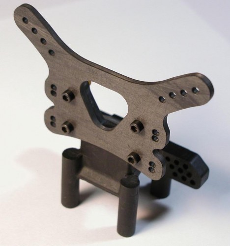

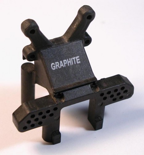

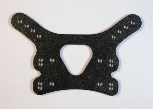

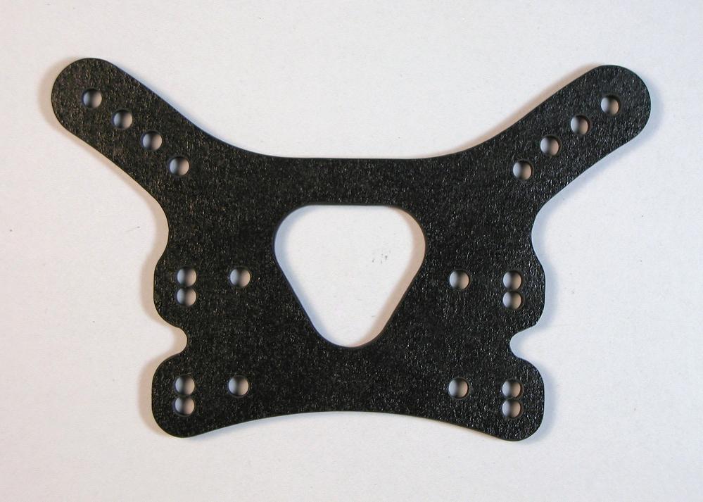

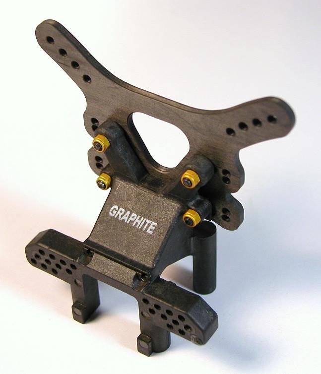

Just an update. I had a bug to work on some more XX4 stuff. I decided to re-design the rear tower, as it tends to be a weak spot on the cars. I think this will solve the problem. I also added another set of wing mounting positions. First you will see my new flat Carbon fiber piece,then a modified Losi rear tower/bulkhead, well you get the idea. I am planning on producing the C/F part, so give me your feedback. Thanks-Jeff

Beautiful work! Cut that XX4 rear mount out of 2.5mm or thicker uni-directional weave CF and you have yourself a winner and a buyer. ;)
Jay Dub
Posts: 1136
Location: San Jose, Ca.
Re: I wish I had one of these when I was a kid...4.20.10 update
Post by Jay Dub »
That piece is 2.65 mm DA Graphite quasi-isotropic C/F sheet. That is the material I have at the moment. I will come up with a cost pretty soon. I eventually will use 3mm woven face C/F, but it will be a while. -Jeff
