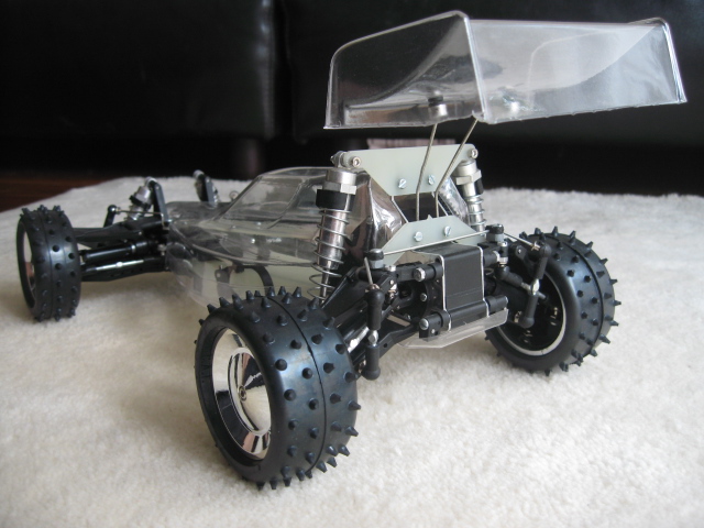

I would definitely like to get some sets of these. However, how many will depend on the following: I wondered whether you would consider using the XL (later version)/XLS plates as your template? The reason being is that they have the two holes close together at the upper rear section of each plate. These holes allow for the option of either following the Procat/XLS suspension fitting (using the lower of the two holes) or the SWB/XL suspension fitting (using the higher of the two holes). See the picture below which illustrates this - zoom in to the bit where the upper rear suspension arms fix to the plates and you will see the second (SWB/XL) mounting hole just visible above where the upper rear suspension is mounted. If you are stuck for templates, I could help you out.....

Update: got the drawings from Fibre-Lyte! The metal fab. co. are sending me a sample of the material so I can check out the finish and try the self tap screws before we go ahead. THE PLATES WILL HAVE BOTH HOLES AT THE REAR SO THEY WILL FIT THE SWB AS WELL AS THE XLS AND PROCAT.
Re: new Procat sideplates?
Update: Fibre-Lyte's drawings are perfect. I've given them to the laser cutters and put down the deposit. THE PLATES WILL BE CLEAR ANODISED. I've also sourced some hex head self-tapping screws like the ones in the kit. I'll supply these and an allen key with each set. You can use these or the original screws. I've checked them in a off-cut of alloy and both fit. However the new ones are high tensile and 'tap' more easily.
