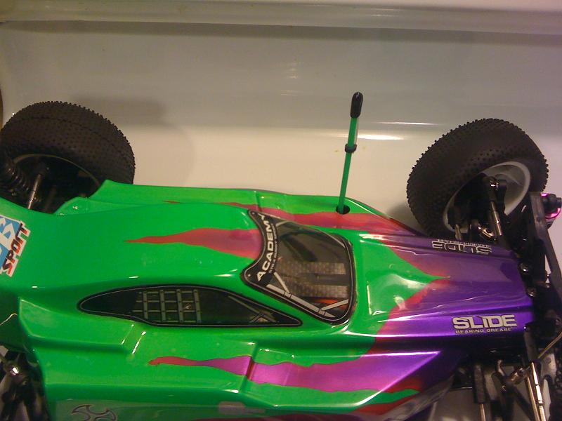

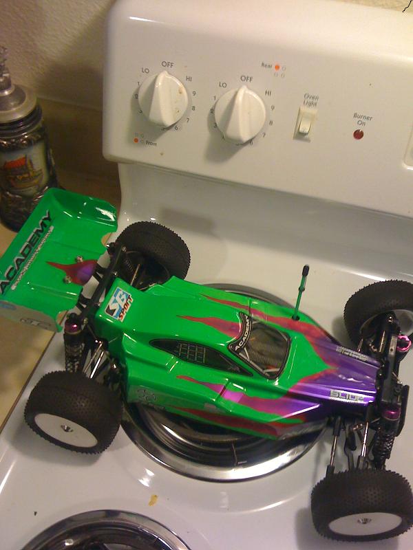

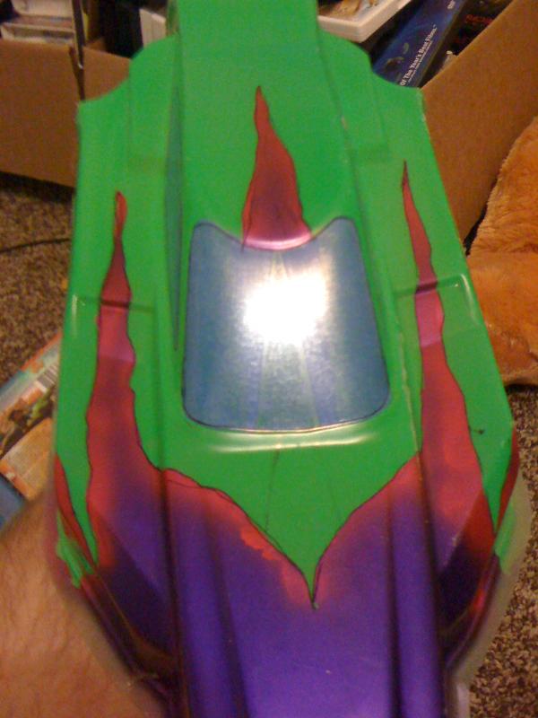

Well I have been my first attempt at a custom paintjob. It turned decent but there is a few spots I screwed up. My biggest problem was that I didn't realize the vent hole on the paint bottle in my airbrush was plugged solid. So it was spitting paint instead of spraying it. I realized the issue after I finsihed the main colors. All that's left is to back the bocy with silver.
Re: Mrc/Academy Sb Pro carbon edition version 2
Well I just about have this buggy ready to race. I upgraded the steering bellcranks to bearings from Avid rc, got the body painted and picked up new Mrc wheels, and have a motor for it now. I was going to throw a 13.5t motor in the car, but another racer was selling 3 10.5t motors since the 10.5 WGT class he was racing went away. So I have 3 10.5 motors that never had more than a 1cell lipo ran thru them so I'll use one of the Trinity Duo's that I bought.
Rebuilding the diffs and shocks tonight and mounting the electronics, then go and drive it at the Toys for Tots race this saturday.
Even with the airbrush problems I was having I'm still pretty pleased with how the body came out.
