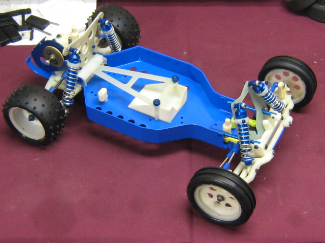

On that blue chassis are those race master rims? Well I also have a white stealth case as well I could use. I still need to find the RPM truck front a-arms like your blue chassis... The ones I have are like the stock white a-arms. I didnt know RPM made the arms white like the ones you have.

they are old proline delrin rims. they do look similar, though.
the front arms are buggy arms designed for the worlds conversion. they're narrower than a truck arm. i don't remember the part number, though. 8003 rings a bell for some reason. could be wrong.
the stock rear shock towers i believe are still available at tower. rpm rear towers and bulkheads are harder to come by.

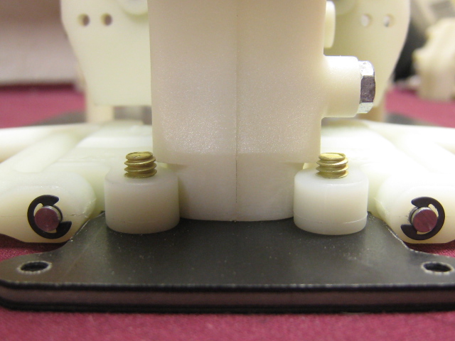

here's an rpm trans case i modified for a worlds chassis.

Awesome modify - was that all with a dremel? The shock stock towers are easy to come by and I have a few RPM bulkheads but the hardest thing to find I think are the RPM Worlds Front Arms. Not sure how I am going to obtain those... I do think I am going to modify the RPM stealth case I have a few of those and 2 more coming from Tower.

ya, i just used a dremel on the case.
the worlds arms are longer than the stock associated and the andy's arms. unless you have the andy's pro race front arms. they are the same length as the rpm arms, but won't fit on the rc10t bulkhead. but, if your andy's arms are white, they aren't the pro race arms.
