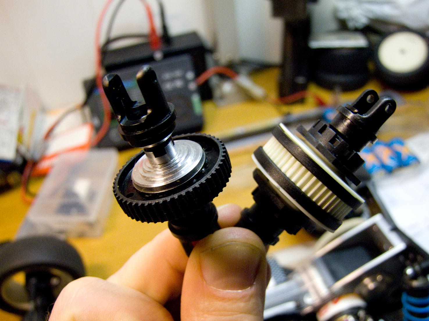

I did some meassuring on the Bosscat Pro Diff pullies to see how much width there is available after fitting the 7mm rear belts. If I would keep the belt fences (and I should, shouldn't I?), there isn't much more space for anything wider than the 4mm standard width belt. I assume that the Procat Diff is providing more width for a wider long-belt or that the 7mm wide belts I use are creating the difference.
However, I can still use a modern Polyurethane belt of your recommendation from SDPi as long as it stays 4mm wide.
Another learning from comparing Bosscat anatomy with Procat anatomy; the long-belt length is seemingly different. I read 323 on my old Bosscat belt and you are using a 320 belt in your Procat. I take it they are not eaqually long then. That's good to know.
I had an idea after studying the exploded view of Schumacher Riot; it would seem like it has very similar but updated drive shafts/yokes. However, it also seems like they are beefed up and that makes me wonder if it would be possible to mix in some of these parts in our Retro Schumachers? The Riot wheel axle seems to be beefed to 10mm diameter, which rules out the use on Works Bosscat rear hubs which only have 8x12mm bearings. At the Diff side of things it would seem like the alu yoke could fit, at least it appears to have the length of cougar 2 Gear box yokes. What is really confusing is the cross interface at the end of the axles; is it larger diameter and if so; will it fit the old standard wheels?
A lot of questions here, but it would be great to have readily available, and uprated axle components for brushless use of old Cats. Have you tried anything like this on your Procat??
