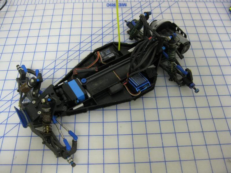

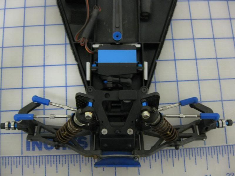

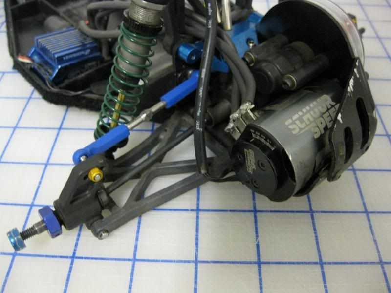

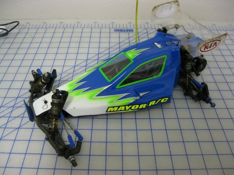

Ok, big update here:
As mentioned earlier, TheBigRC.com and I put on a local series and included a vintage class. It was quite the hit, we saw a few older cars that probably hadn't seen the track in 20 years, all of which were fast. There was brushed VS Brushless, Losi VS Associated, and lots of great battles.
The RC10 was the most popular car for sure, with Mo Hille taking the most wins with his RC10 Gold Pan with Kyosho Small Bore shocks.
What was cool about the series is that we didn't frown on updates/backdates, so it was neat to see how the B3 compared to say a JRX. Hands down, the biggest difference to any car was tires, and our results showed that even if a car is 20 years old, with an old AM radio, mechanical speed controller, and an old Trinity 27t, that it can still run with a B3 with modern electronics.
My car has a ton of updates as I usually run Stock Buggy with it. It's so fun to throw the car down, see the heads turn as it makes it's way down the straights and into sweepers. Local pro Dave Ehrlich (IIC, Snowbirds winner, former ROAR National Champion) drove the B3 and said "This is the funnest thing I've driven off-road!"
Here's what's on the car now (In addition to list on Page 1)
-Thunder Tiger top plate (More steering at slower speeds)
-LRP SXX V2 Stock Spec (Lower Board Update)
-Stock B3 body
-B4 Wing (Cheap!)
-Carbon Shock Tower
-Mayor R/C Refinished B4 Top Shaft
It's been a ton of fun racing with this car, I just wish I could've gotten a picture of what it looked like when I started. I built this project to show everyone you don't need the latest and greatest car, batteries, motors, etc, that ANYTHING can be competitive given effort. Thanks to Ebay, I was able to source a lot of parts on the cheap, like the shocks. I've also been buying a lot of B3/T3 parts from the clearance bins at local hobby shops
What's next? Well, I've still got a ton of cool stuff in the works for the B3. I've also got a T3 project I'd really like to start on soon as well
And there's a lonely B2 sitting in the garage....maybe time for a new breath of life?
