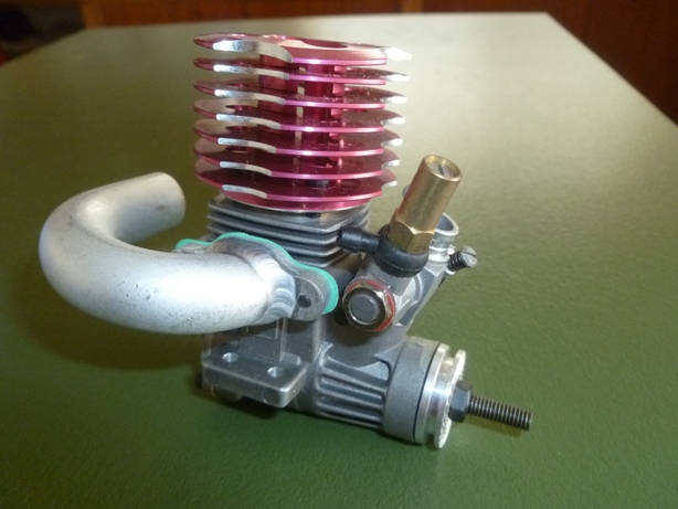

I see what you mean, I found a few of the Schumacher Engine Installation Sets in my spares pile, two for the ASP/CS 12 PS, and one for the XR15/OPS15/MEGA15.... not one for the Leo 12, unfortunately. In the instructions, they talk about removing the original clutch, and putting on a combo of cone washers and flywheels.... the cone seems to go over the part of the engine output shaft that does not have a thread on it.
I then found (don't ask how) my unused Leo 12 motor, and I see what you mean, it does have thread all the way to the bearing, unlike the other motors Schumacher show in the instructions. This to me means you have two options: Find a Leo 12 to replace your old one, or adapt one of Schumacher's installation set kits to match the engine you buy.

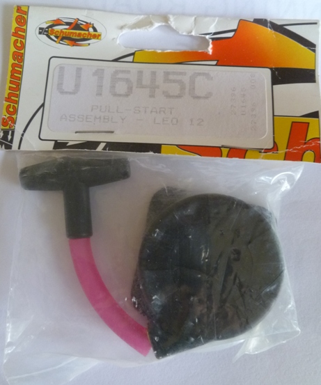

One of these?
Yeah, I can help you with a couple of those.....

just to make sure, is the pic attached a leo 12??
Re: I need advice on buying a new engine for a Schumacher Nitro 10
hi Alex, does the pull start assembly come with a one way bearing ?

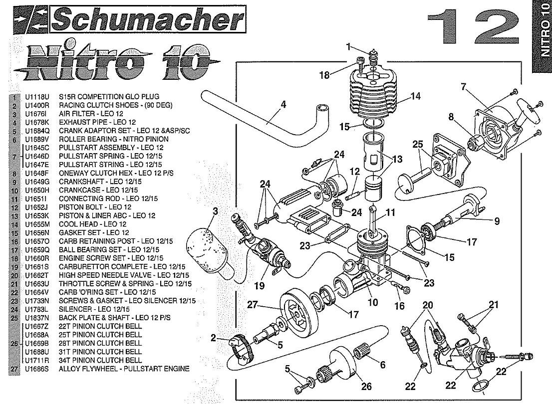

From the 1996 Schumacher catalogue, this is an exploded view of a Leo 12.

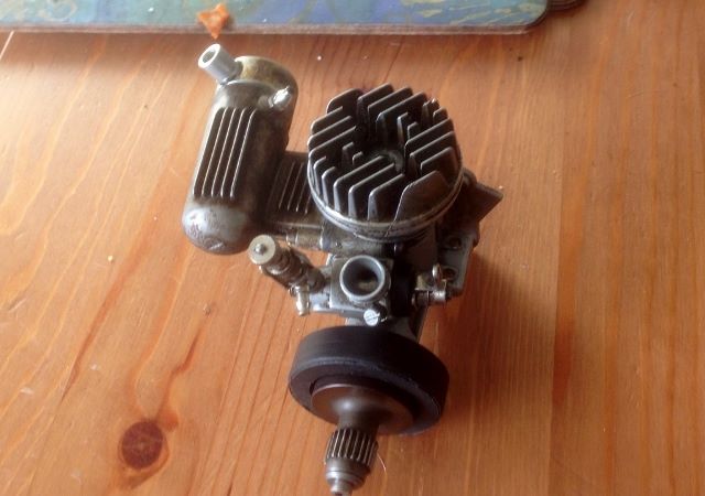

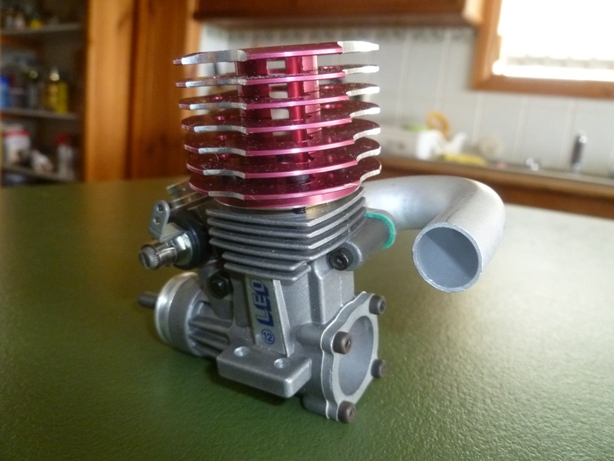

My own Leo 12 looks like this:
As for the one-way bearing, the pullstart packs do NOT come with one... that's a separate part, U1648F (from the diagram). Don't seem to have any of those, sorry.

Hi Alex, thanks for that, from looking at the pics, my engine is def a leo 12.
