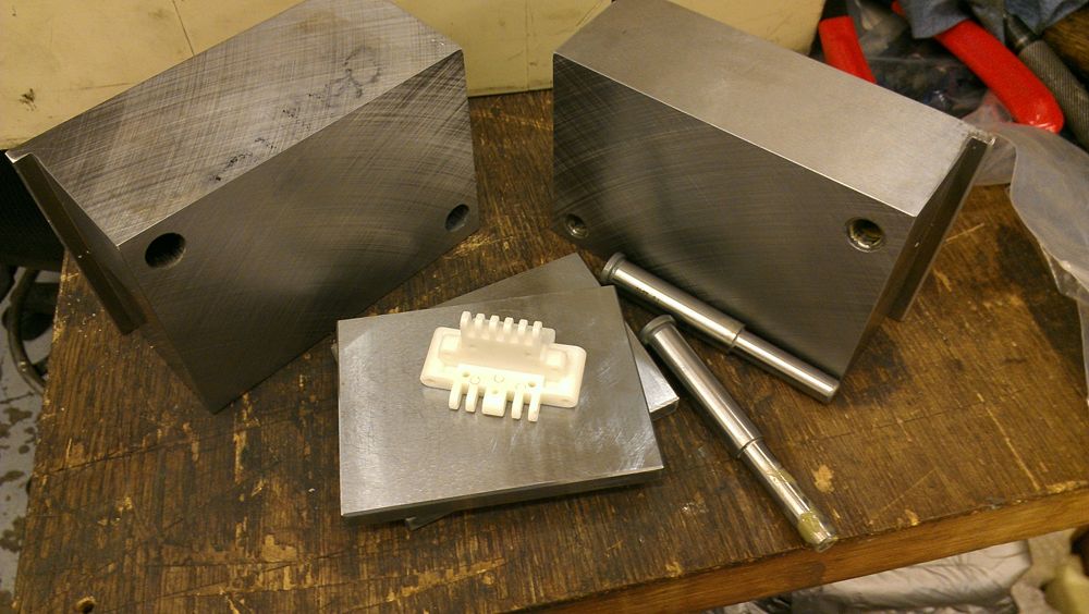

Great news, the cutting of the mold steel is starting.
Here is a pic of the raw steel parts and a bulkhead to give you idea of mold size.
So think on track for late February - March time frame hopefully.

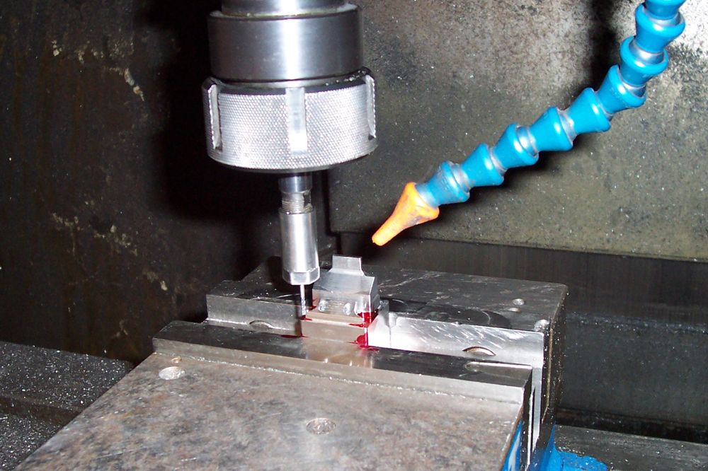

Here is the first pic of the cutting.
This the under side of the part, forms the inner cavity inside the bulkhead.

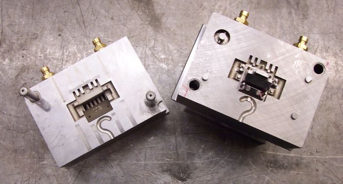

Ok latest update, the mold is pretty much complete.
They will do a test run of parts in about 2 weeks. So looks like March for sure and I suppose it could slip to April if any issues come up.

Picture of the mold so far.

Looking good.....! This probably explains the recent increase of XX front bulkhead's that I've seen on eBay......everyone's trying to off-load while they can.....and who can blame them? This new mould for the bulkhead will keep the XX/T going for many years to come!mytimac wrote:Picture of the mold so far.

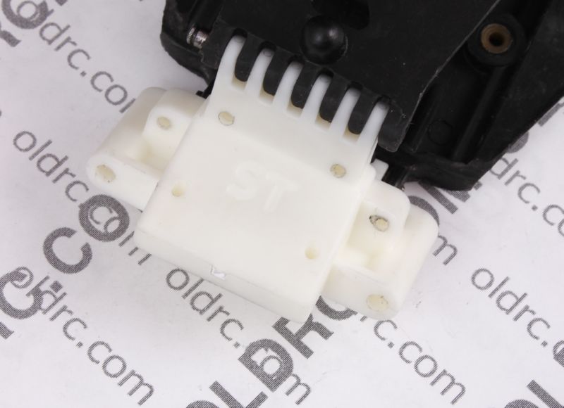

Well got to see the sample run of parts today. The good news is that all the parts fit together with the new bulkhead.

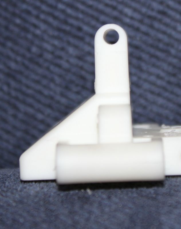

But there was some bad news unfortunately. While the bulkhead would be useable in its current form, it is not up to my standards right now. Some place during production they made a mistake in the upper brace hinge pin hole. The hole is far too close to the top.(see the picture below) This means there is even less nylon material than the originals between the hole and the top. We all know that for the XX bulkhead that is in exactly its achilles heal. No point making the part that is going to be for sure worse than the original.
So they are going to go back and review what happened and try to get it fixed. It could be that the hole is in the wrong spot or that they didn't make the top of the part deep enough in the mold so that there is enough material flowing into that spot in the mold.
The guy at the plant who is the pro for this stuff is going to be out hiking in the Utah desert and won't be back into work until the 24th of March.
So it looks like it won't make a March release, it will be at least April for sure.
