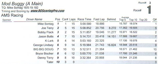

With the two usual super fast guys not present this week, I TQ'd and very narrowly missed first place of seven in this weeks club race.

This week we had a low turnout... especially in 17.5 buggy, so they ran the stock buggies with the mod buggies.
I changed upper shock mounting holes and went to 35wt front shock oil, but otherwise the same setup as I had been running. The speed difference on this track layout was apparent only in that the mod cars could easily clear the big doubles, while us stock guys have to get a really good run up to avoid landing on the crest and bottoming out hard. I won stock easily and was competitive with most of the mod guys. If not for a big "OOPS!" crash which was my fault and getting run into once, I would have had 3rd easily

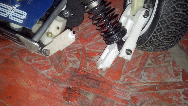

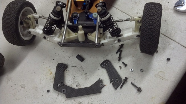

A few horrific crashes with 8th scale newbies on the track resulted in a broken CF front CE tower, among other things
This prompted me to rebuild the front end with fredswain's shapeways arms and Niki's bb spring adapters. Also changed to an aluminum B4 top shaft (the kind that still takes the spacer) and avid triad slipper to shave drivetrain mass. I've added about the same amount of weight with the front arms, bb spring adapters and a new battery cup. Lots of new parts on this old car now
As soon as my new set of short axles arrives It'll be ready; I should be running it in practice this weekend and club racing next week

The new replacement shapeways arms showed up last week and they are substantially different from the ones I had before. Maybe I will contact them about this...
1. The pin holes did not require drilling, the pins pushed through easily and they are perhaps even a little sloppy in the holes.
2. The surface finish is nicer/much smoother.
3. The nylon itself seems to be a different type. As I broke the arms apart from each other last time I was able to flex them back and forth exactly 4 times before the webbing snapped. This time, I was able to flex them only one time.

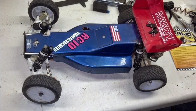

Last week I managed to turn the fastest lap for stock buggy. Qualified second and finished 2nd of 10.

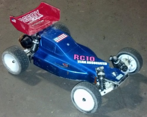

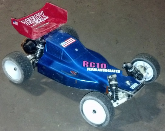

Re: 2015 Championship Edition re-fit Racer/Runner
I have the car pretty much what I would call 'dialed' without having changed caster or rear toe/anti squat. After racing back-to-back with both cars numerous weeks it's clear now that:
-The car has slightly more understeer in general with the shapeways extended arms vs regular long arms. I swapped both arms and ran it at the same static camber and toe settings. I feel the car is more stable and planted on corner entry with the longer arms, so I am going to keep running them for now.
-I can drive my B5M significantly faster (between .5 and 1 second per lap on three different tracks).
-The RC10 takes substantially more effort to drive 'at the limit' than the B5M does.
I'm going to keep running the RC10 on indoor clay during the winter whenever I need a challenge... and for nostalgia sake. I absolutely intend to continue trying different things in the future, including caster, anti-squat and rear toe.
