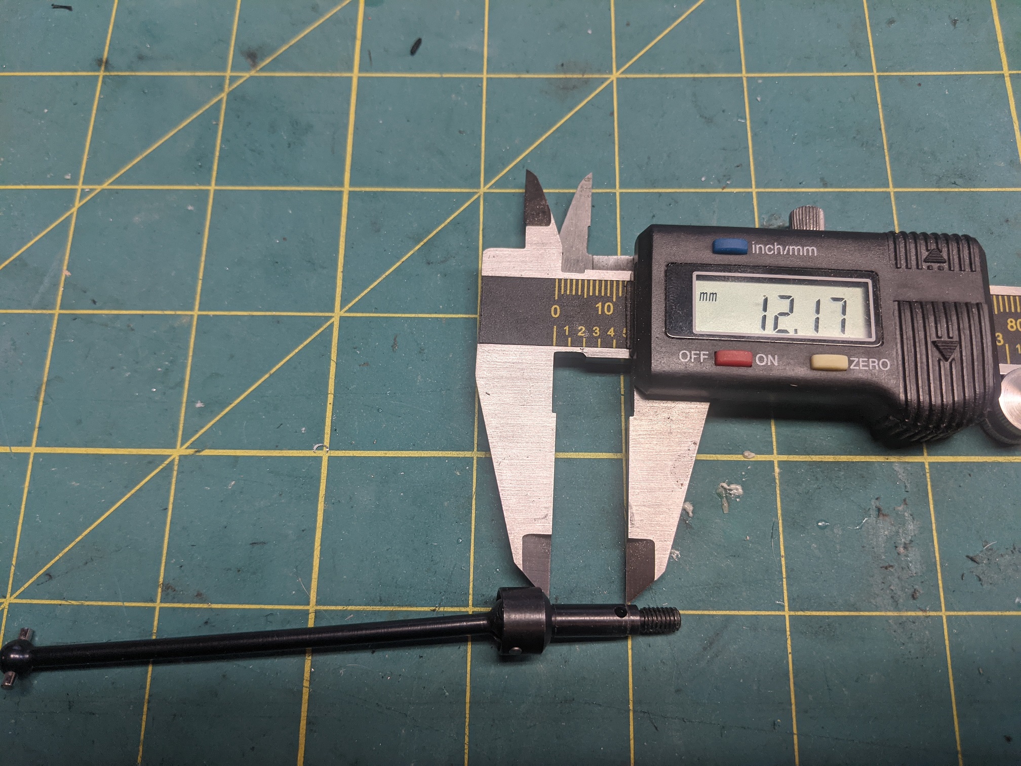

Hey Ronbo, could you please post a picture of the front or rear axle without wheel and hub?
I'd like to see how you sorted the small flat for the hub's grub screw..
Thank you!

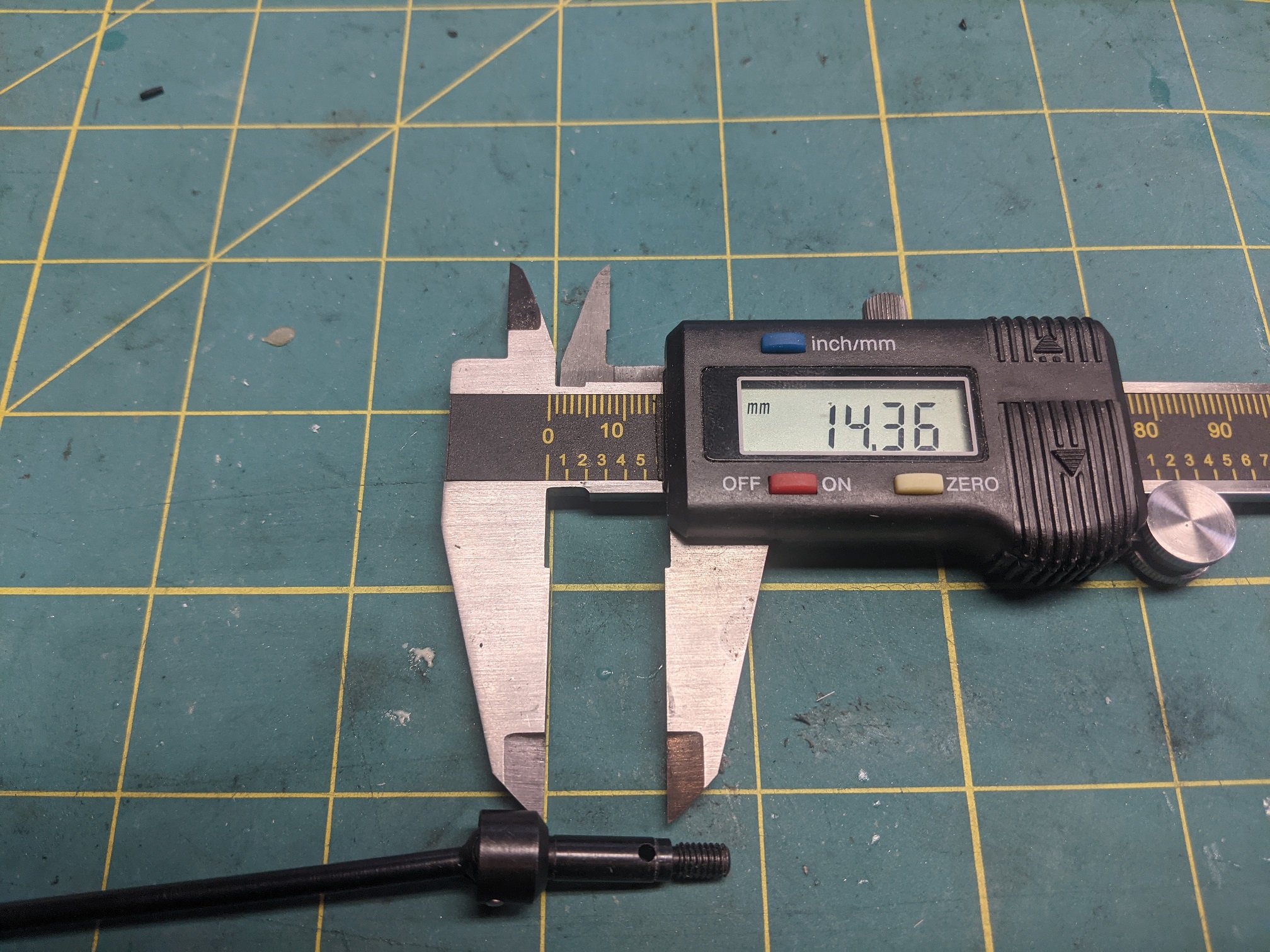

Here is the DB01 out of package and the dimentsions in question. I havent inspected the axles on car yet or made the flats. but i believe the flat will go 90 deg from the pin. Im of course concerned about metal stress and fatigue if when i do that. I also have pins and Associated blue 5mm hex adapters to try to run modern rims as well.

Ok, time to update. I got the newer CVDs from a good gent on Facebook. Managed to get the equivalent to the ZC422 and 423. 1 pair 422, 2 pairs 423. Still waiting on the ebay 422s CVDs i ordered in November! Ive set the car up already with them, 423s on all 4 as the RPM rear hubs move the geometry out, thus using the longer shafts. Using the Shapeways rear RC10 for metric bearings should use the 422 as the original car did.

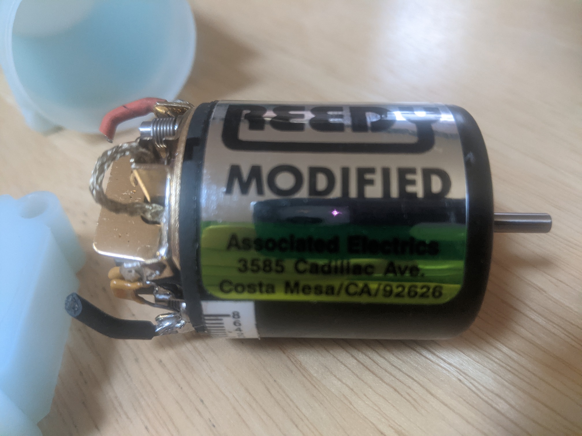

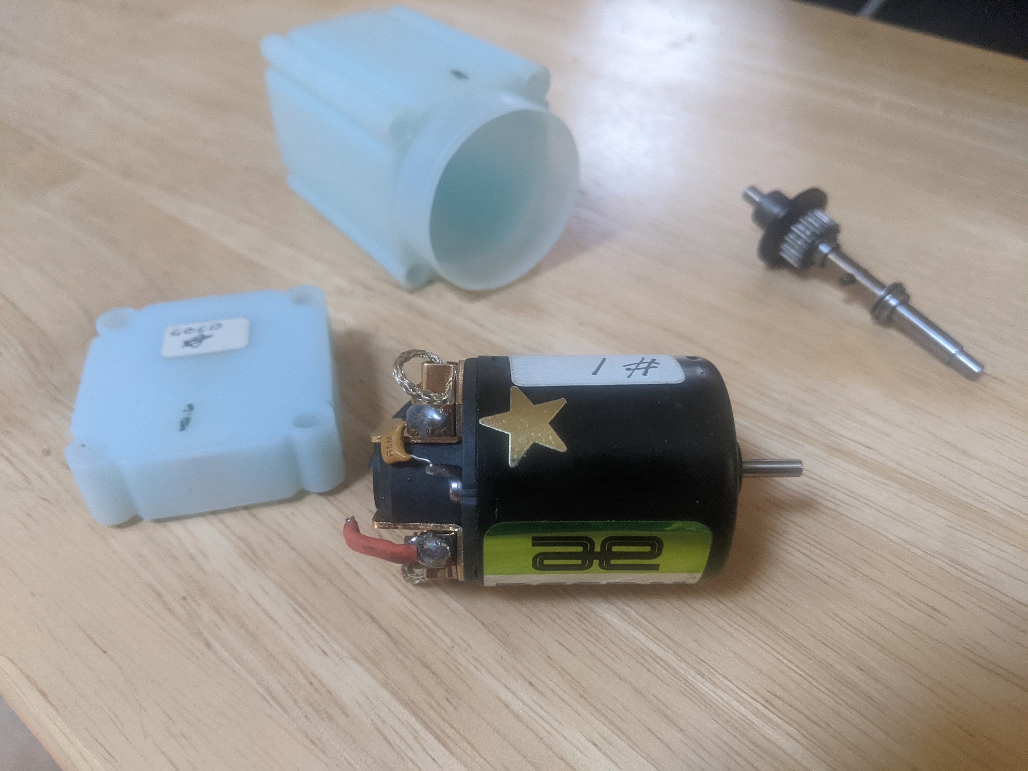

I still need either a longer steering rack to meet the brace, which had to redrill since its short from Vintage RC kit. Would rather have a compete rack setup as i need a similar setup for RC10GX project. Also would like a period correct Reedy modified motor like original car. TF 31 and 32 tires for display. Need to look into any modern tires that look similiar, as its pricey to get originals.
