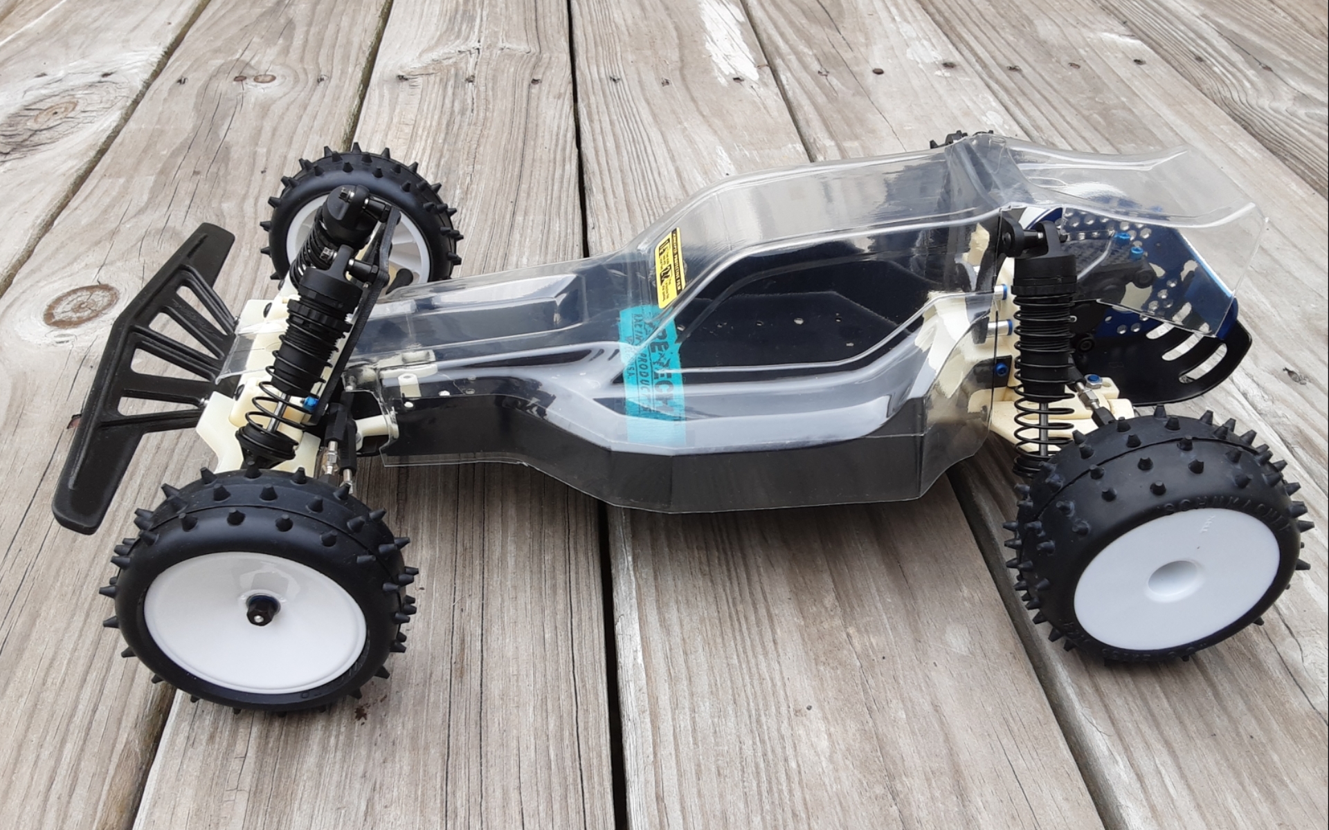

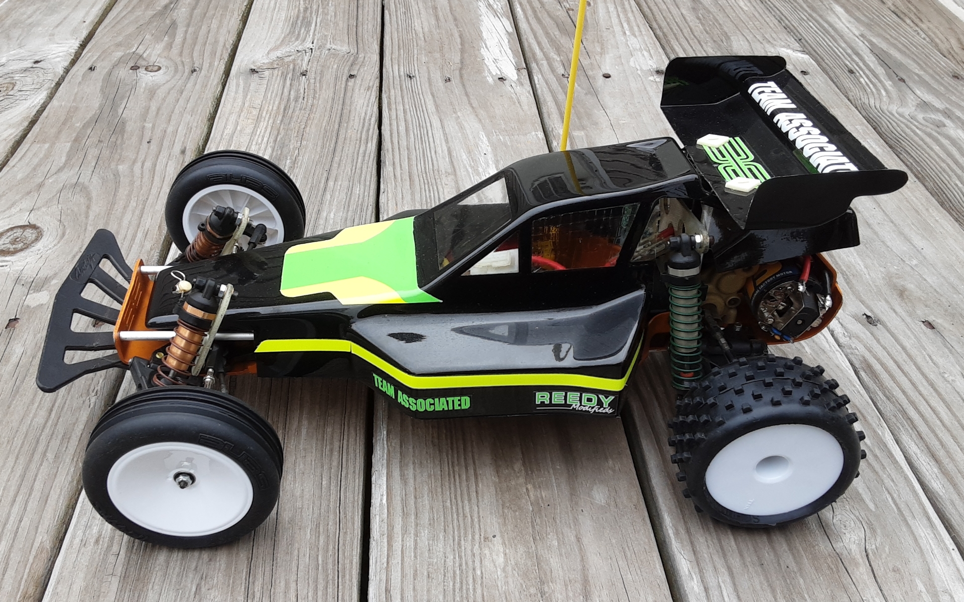

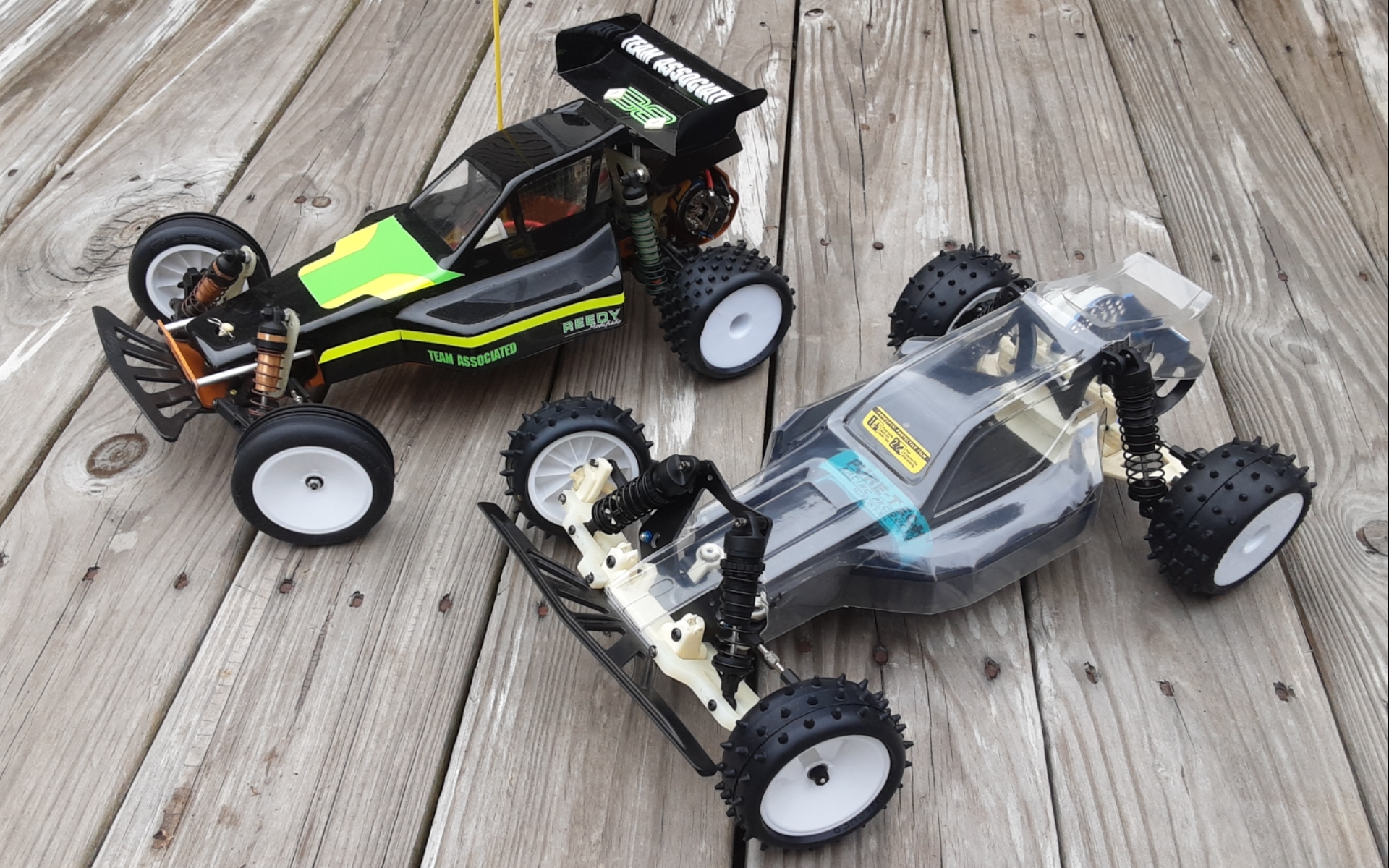

Here are a few pics of the JConcepts fronts and Traxxas rears on a couple cars.
The clear body car has Schumacher full spikes all around. The black car has Schumacher blocks on the rear and Traxxas Alias fronts. I may change the blocks to something else, as they are a little small.
Click on images for better resolution.
