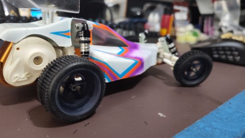

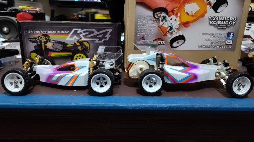

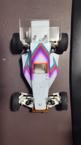

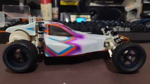

While my NRC24's electronics were taken for the K24 I still haven't stopped doing stuff to it. Recently it got a fresh body painted up and I made some mini Turbo Scorpion wheels for it to match it's larger sibling.
I did notice that the rear track width of this car was a lot narrower than the front, by 10mm, with the original wheels. While this doesn't sound like a lot, it's rather huge when you consider this is a 1/24 scale car. I decided to make lower offset rear wheels to make up this difference.
I'll paint them later.Consistency is the key I keep misplacing.
