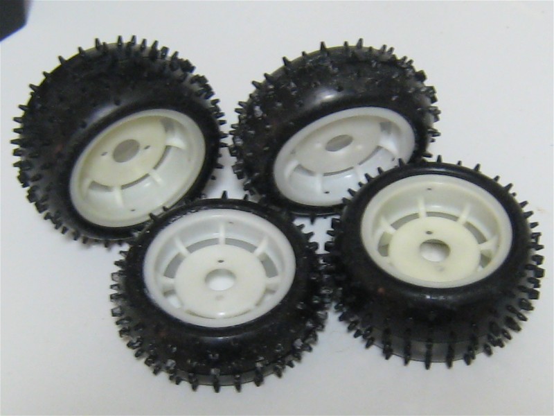

i haven't really done anything with rebuilding the car yet. but, once the car has served it's purpose (09 nats), and is relegated to live out it's life on the shelf, i finally got the rims and tires i want it to sit on.
2520/2550 front and rear proline rims (all new)
pro-35/pro-60 front and rear proline tires (all new)
the front rims are whiter than the rears, so i'll just blow some cigarette smoke on them for a little while until they all match.

Re: my 870c / '09 v-nats entry
just put some Super Clean in a old butter dish or tub with a lid and let them soak for a few days. it should whiten them up.

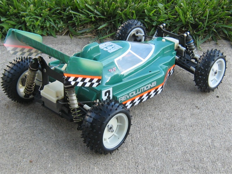

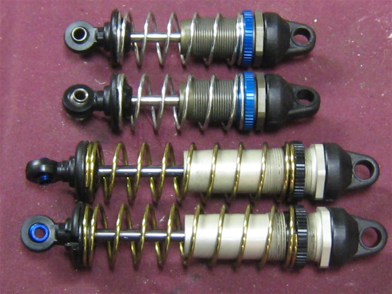

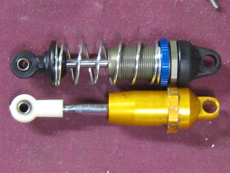

little update....
i read on the 870c parts list that websteve posted awhile back that the associated replacements for the yoke shocks were the .56 and 1.02's. since i wanted more ease of adjustment for this car, i picked up a nice used pair of 1.02 threaded shocks of ebay, and since i couldn't find any used "coated" tc3 threaded shocks, i had to buy them new. i'll eventually swap out the blue spring collars for black on the fronts.
instead of using the tc3 shock shafts, i installed .56's. now, they're the same length as a standard .56 shock.
- Posts: 16816
- Has thanked: 36 times
- Been thanked: 1318 times

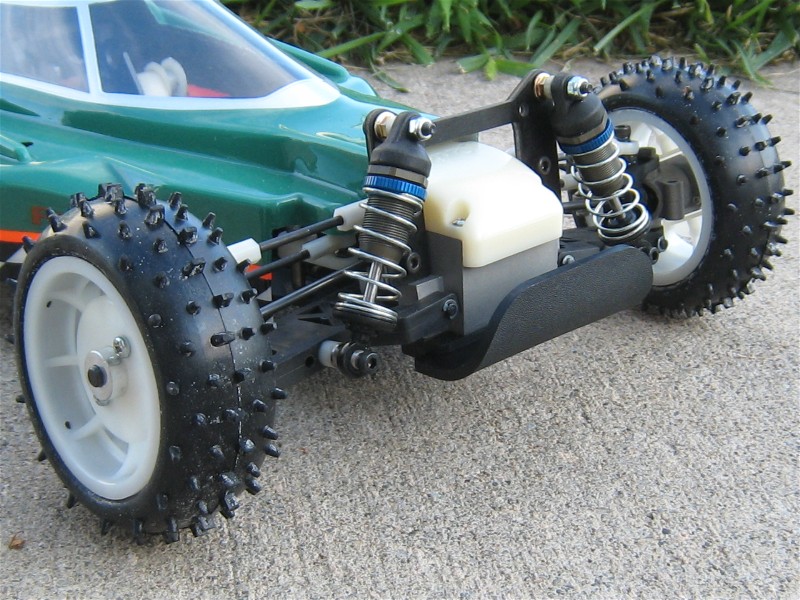

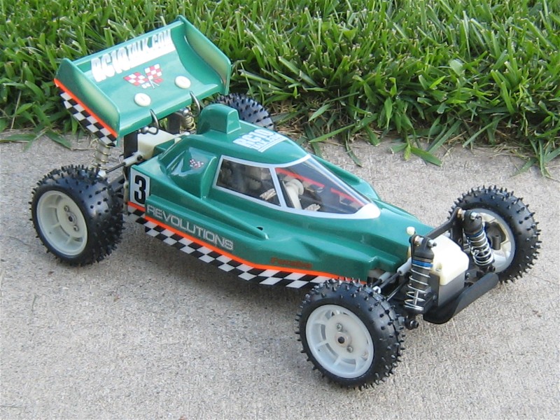

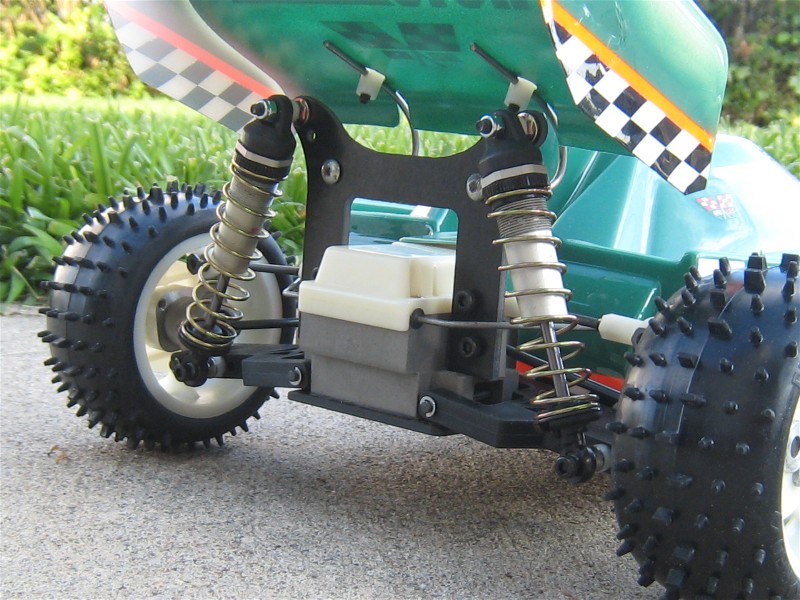

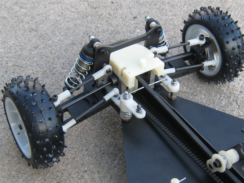

alright, she's finally a roller. i still have a lot to do to it yet, but atleast it's together.
i ended up going with the wide front suspension setup. mainly because i needed 2 new stock length universals and couldn't find any. my lhs has a stack of the wide kits. and because of the wide setup, the lunsford tierods i had set aside for it were not long enough. so, i'll be swapping them out when i get longer ones.
Damn, that cleaned up nice. I don't remember it looking that good when it was mine. You have an undertray right?
yup, i have the undertray, just didn't put it on yet. i'm gonna get the radio gear installed on it first (i think).
