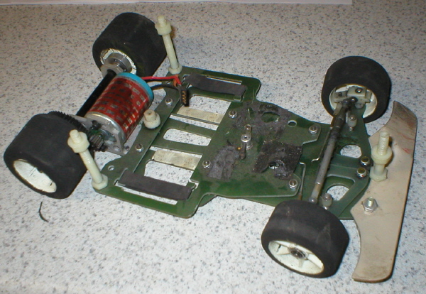

racer484
Posts: 26
Joined: Tue Dec 11, 2007 2:59 pm
Location: Toronto, Ontario, Canada
Re: Bolink Bandito Build up
Post by racer484 »
Yeah thats a little issue i cant seem to find a period picture with the speed controle? i dont think a ESC would be right but i cant figure out were i would put a resistor and sweeper
Vey nice car! :D
I'm 99.9% sure the Bandito came out later than you are thinking. The Bolink Renegade, the similar design to the AE 12i was still the latest 1/12 Bolink car in 1984. The Bandito came out in 1985, that's the year I raced it with a Futaba R4H, S32 and a red Tekin Mospower speed controller. The Novak T1 or 4 and NER2S Rx would also be correct.
There was a 4 cell radio tray available with the batteries in a saddle configuration like your picture. Between the cells was solid glass over the T-bar. This was the ESC location. If you only had the 6 cell tray, guys built a little fiberglass bridge to put the speed control on. If you were running 6 cell the ESC and RX went behind the steering servo on either side of the antenna.
Attached is a Bandito I recently got from Steve Rule showing the correct wheels and nylon screw type body posts. You can see the servo tape residue show the electronics locations.
Hope this helps,
Marc
