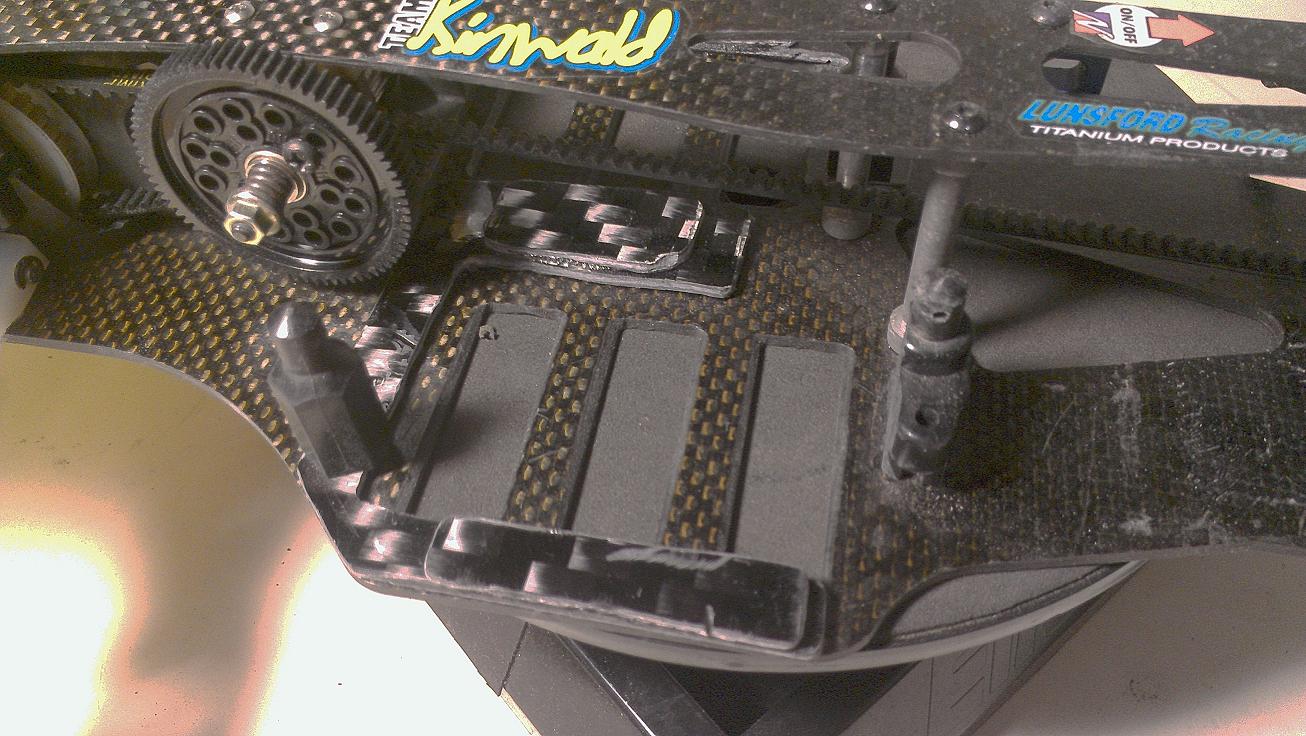

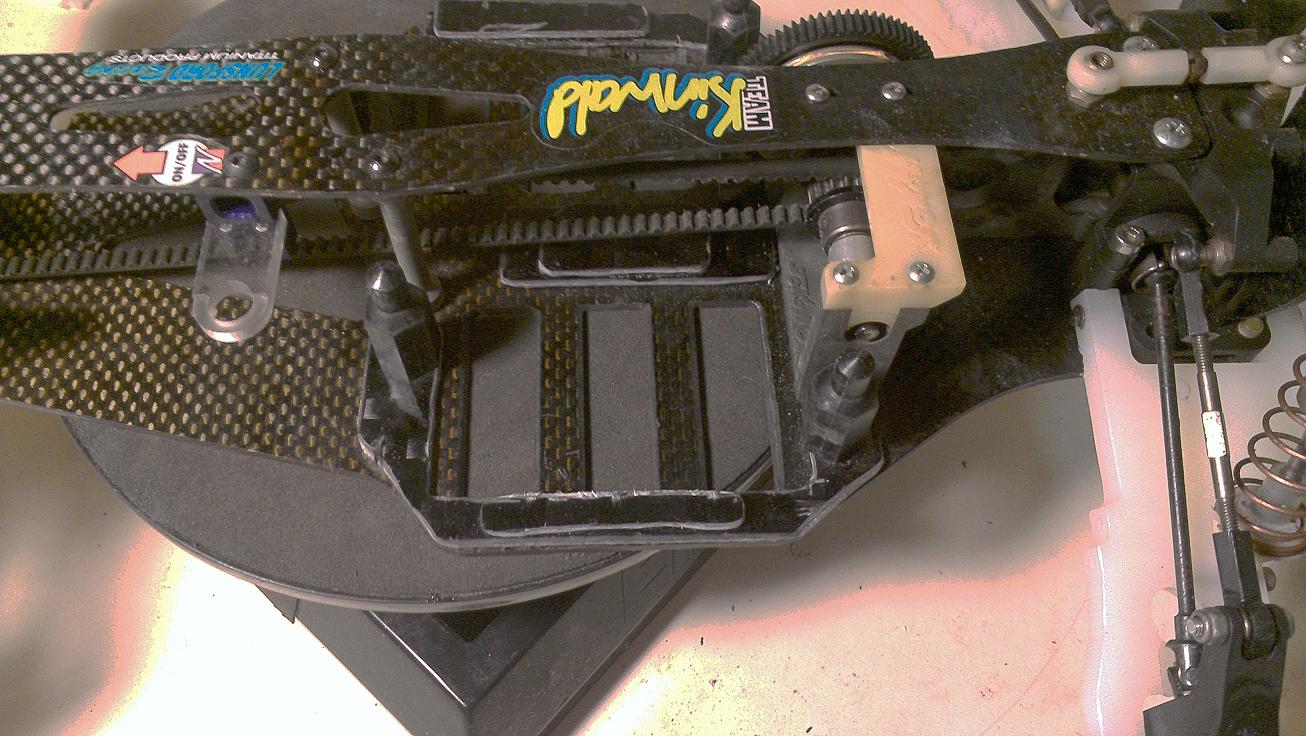

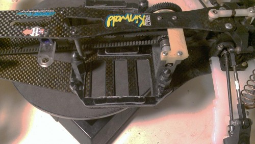

Well, I was feeling ambitious today, so I decided to make my own. A ruler, some eyballing, a marker, and a dremel...and a few hours of iterative cutting...and I ended up with this. It's handmade, so it's not "perfect," but it fits lipos nonetheless. After the glue is dried on the stacked pieces, I'll put the appropriate spacers under the posts to get the right height for the clamp plates.
One of the main issues is that the motor mount and the center posts get in the way a bit, so I made one of the trays U-shaped (left hand side) and the other tray C-shaped (right hand side). The "top" of the C-shape sits in between the saddle packs to prevent side-to-side movement. I figured this would be better than gluing a chunk of carbon fiber in the middle. Both of these trays are not glued to the chassis - they are held in place with the same screws that hold the battery posts. I did have to trim the front right hand post a bit, so that I can push the right hand side lipo forward so that it does not run up against the spur gear.
Not too bad for a hack job...
