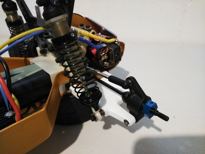

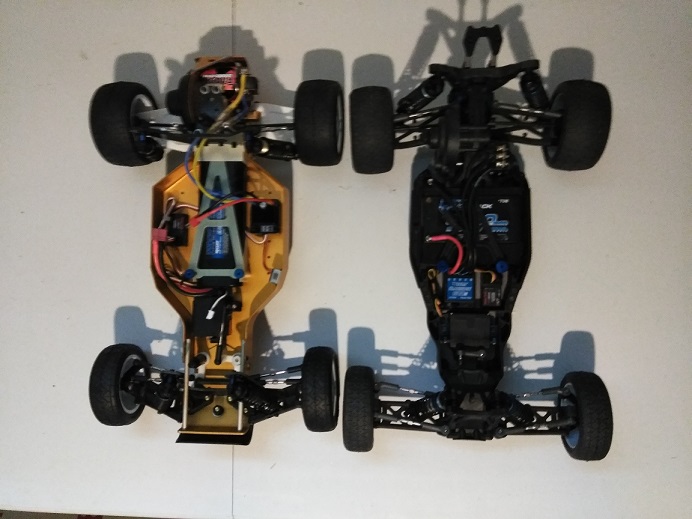

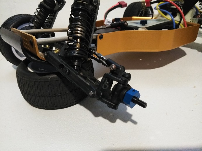

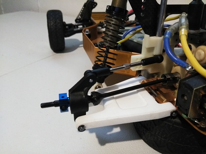

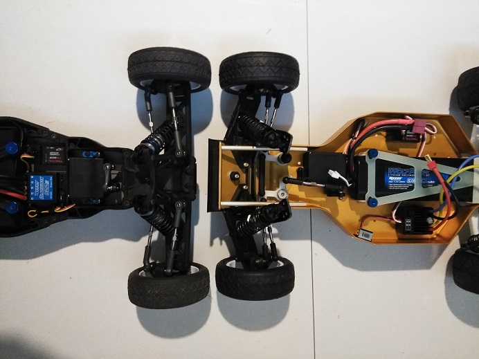

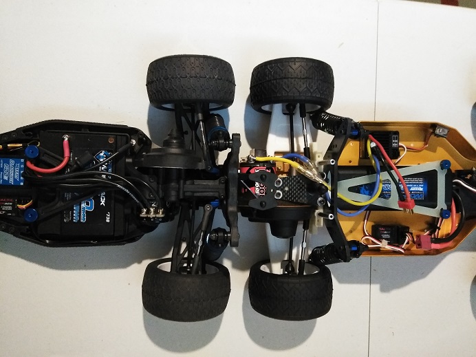

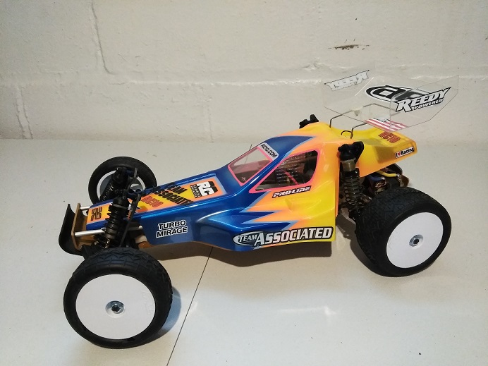

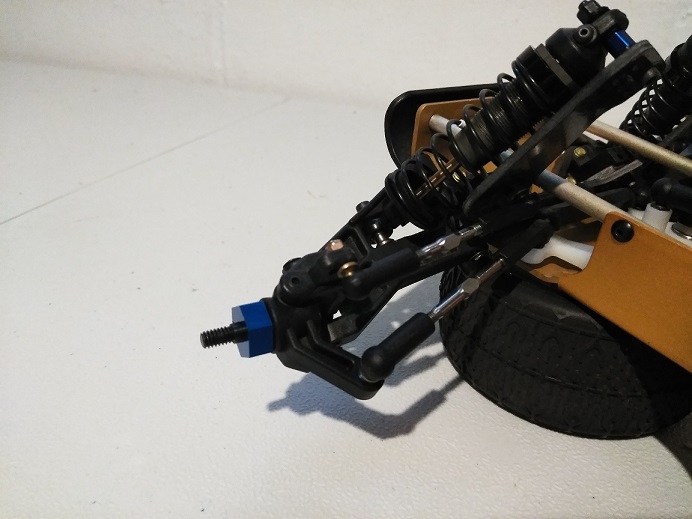

Hello . Well I guess these days 2.2 hex wheels are the new modern . This is my RC10 Conversion and comparison to a B5M. The shapeways arms seem to be duarable took couple hard hits and nothing broke (yet) .
Front - B4 20 degree caster blocks .
B4 steering blocks- lower hinge pins drilled to 1/8 inch.
Schelle racing spin free axles for SC10 .
SC10 front hex's .
B4 steering blocks hinge pin plus 2-56 X 1/8 keeper screws .
Rear - Shapeways wide rear arms NIX63551 .
B4 cvd's .
B4 rear hex's .
RPM RC10GT rear hubs plus 3/16 X1/2 inch bearings .
Punisher 3 X 50 mm turnbuckels .
Punisher ball cups .
Wheels - Proline 2.2 Velocity B6/22/RB6/ZX6 Hex front and rear .
SC10 front hex's .
B4 cvd's .
B4 rear hex's .
