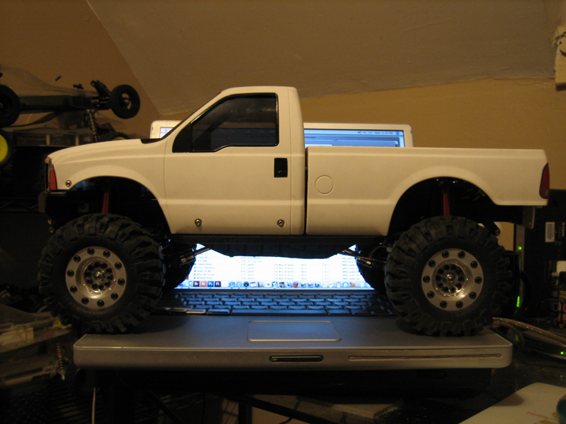

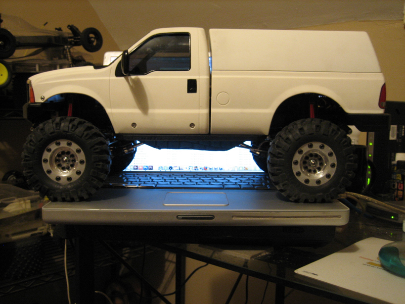

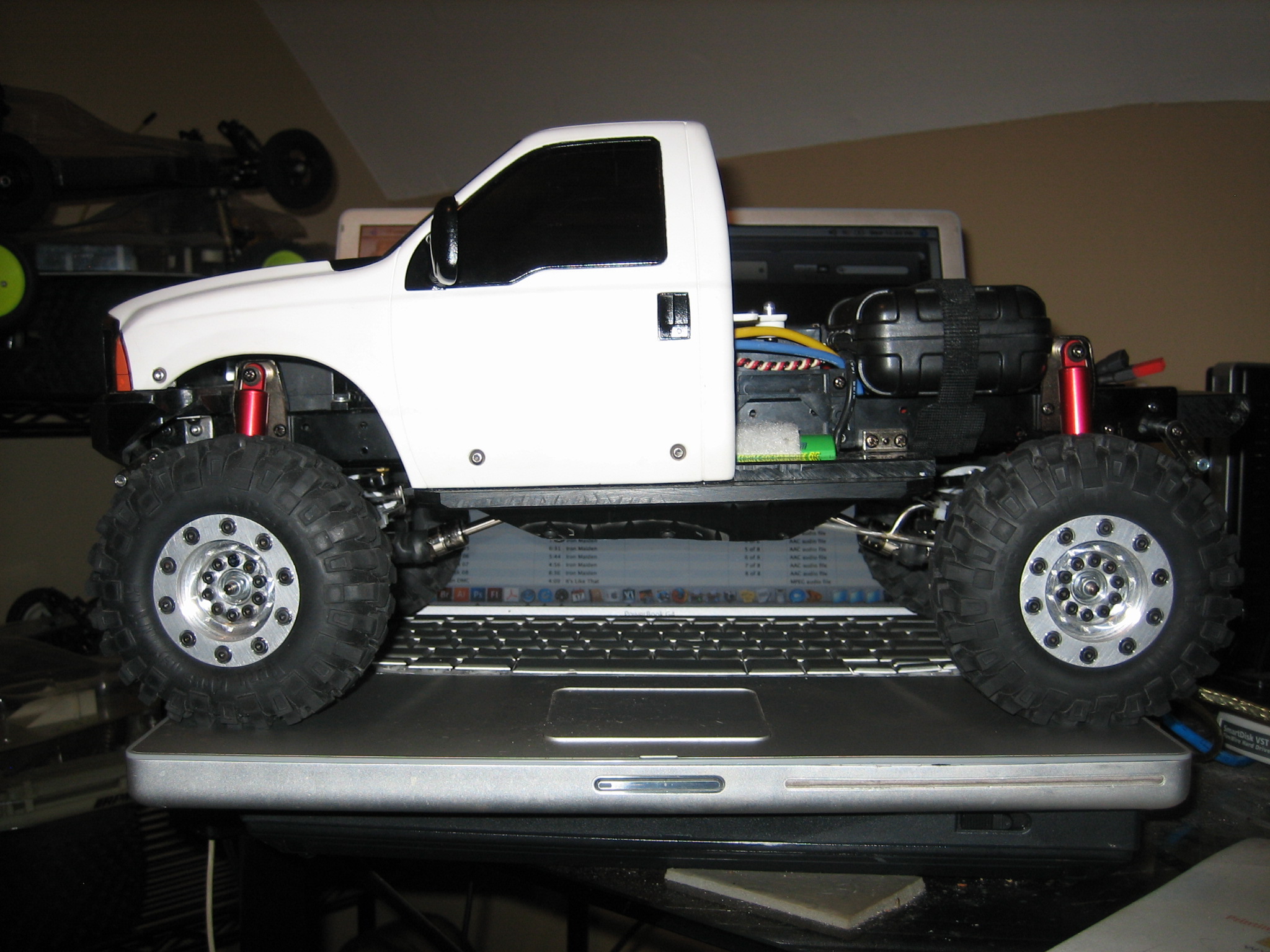

given the choice between starting with a rc4wd rig or a tamiya rig i would have to say the rc4wd if you are going for scale.
the bodies are different, but the chassis' are the same. the chassis is one of the things that kills the scaleness imo, i wish they had made something more like the old bruiser or new scx10. the tamiya chassis is just 2 straight c-channel rails. it gets covered up with the body, but still, not near as scale a chassis as a rc4wd or axial.
heres my hilift f350. its a total beast and i wouldnt trade it for anything, but it took alot to get it to this state.

That's sweet dude.

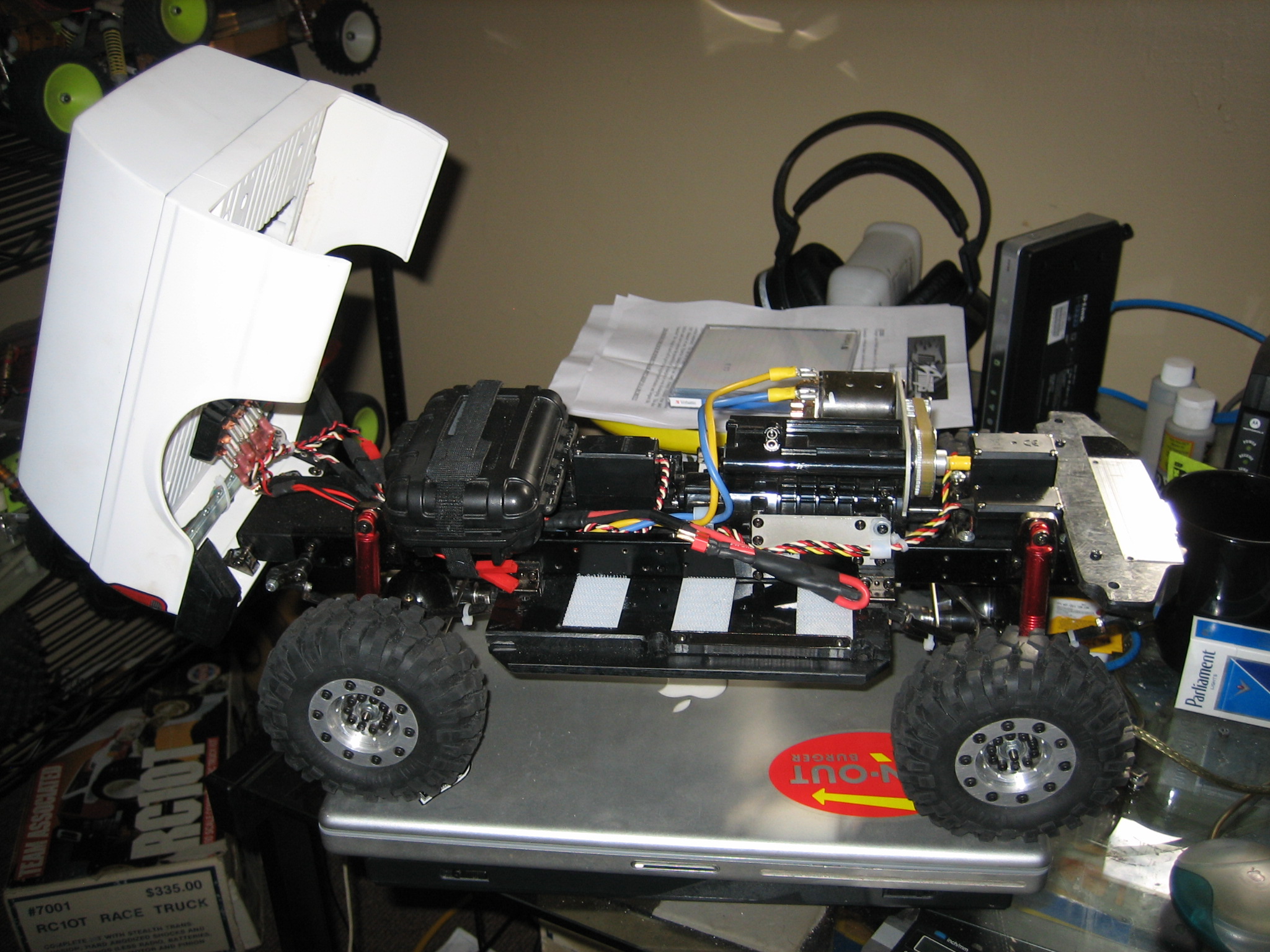

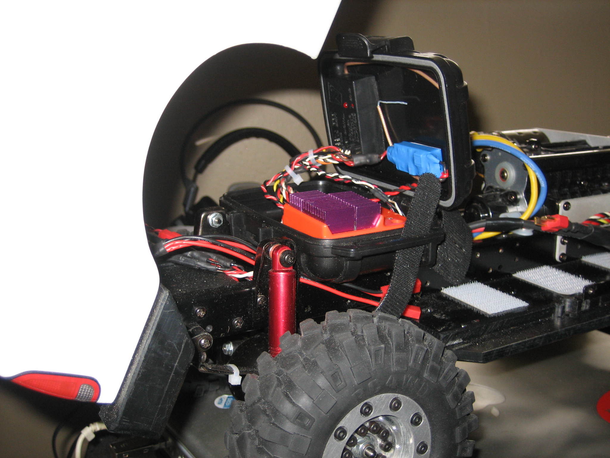

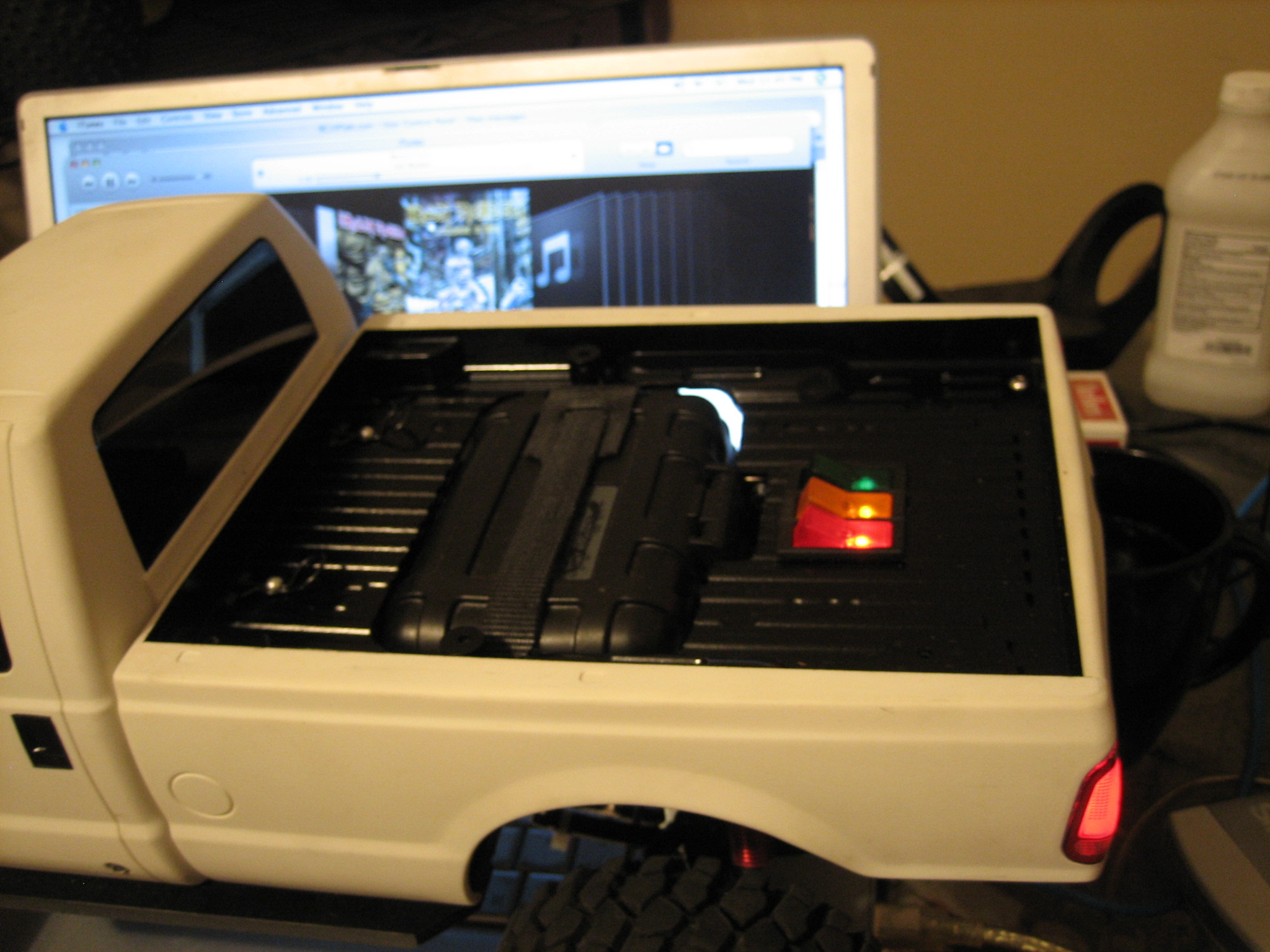

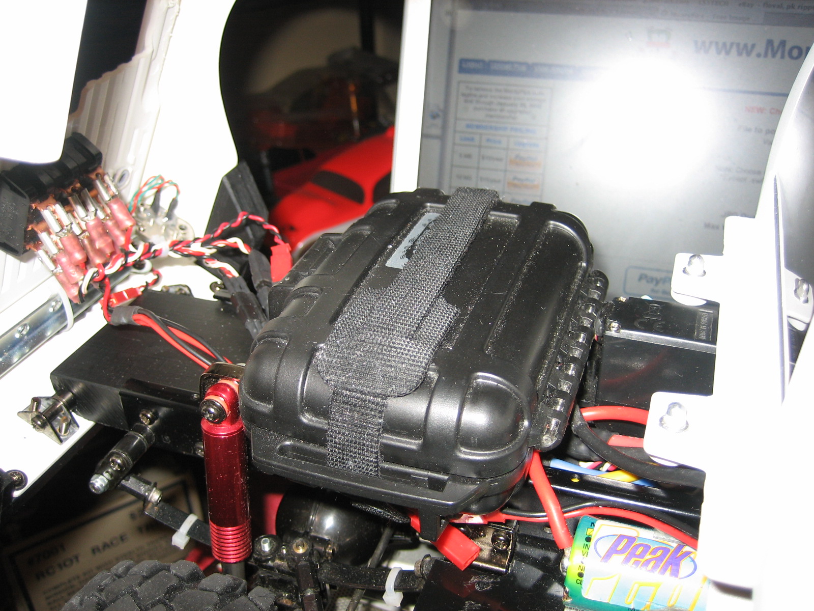

Thanks for re-posting them. Do you have the MFCU thingamajigger? What is the black case strapped to the bed?

its a waterproof otterbox i modded to house the electronics. supposedly watertight to 10'.justinspeed79 wrote:That's sweet dude.Thanks for re-posting them. Do you have the MFCU thingamajigger? What is the black case strapped to the bed?

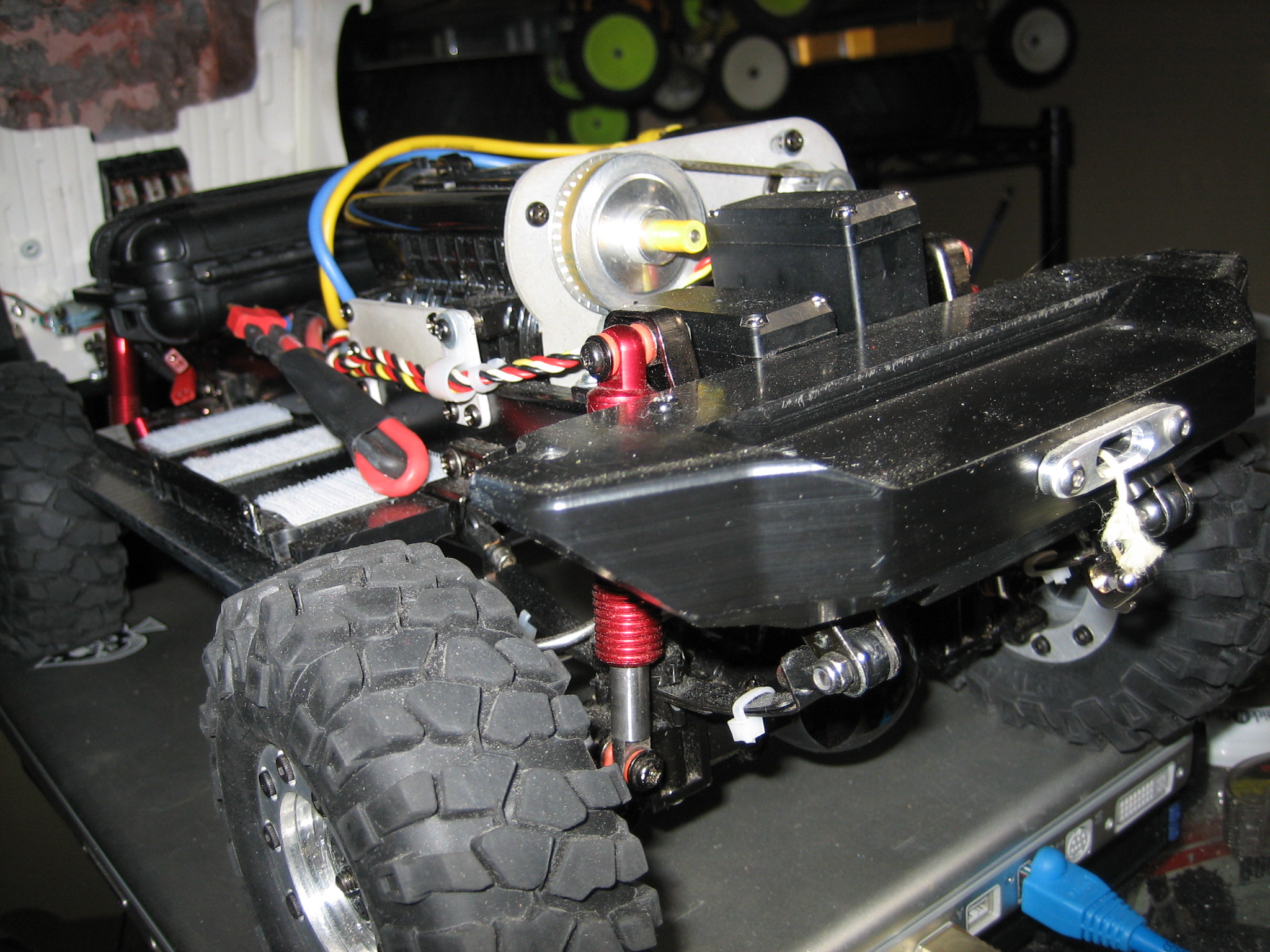

heres some body off pics before i put some rc4wd dino axles on it. custom bits include a german-made clocked motor with belt drive and raised tranny, solid delrin bumpers and side rails. switches in bed control the lights, power, and winch. traxxas ball-ends mounted to the leaf springs let it flex like crazy but not be sloppy. they kill a little bit of the scale look but they really free up the suspension.
