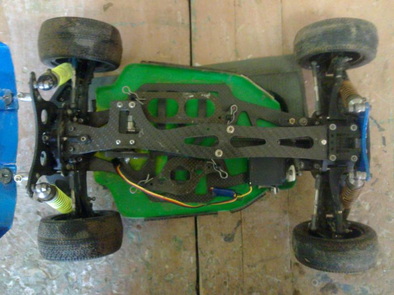

Dual, thank you so much..I have had this piece for a couple years..I sold 2 in the past as some of you remember it got up to about $100 to my surprise... Not sure if I want to part with it just yetDual wrote:To Hairymuffin,
The reason the rear part of the 2 piece top deck does not fit is because the top deck is upside down. This option top deck was designed for the Pavidis Edition Yokomo (your model is the 1994 YZ10) and the Pavidis Edition chassis has one of the top deck posts mounted further forward compared to the 94 YZ10.
You would have to drill 1 new hole if you are planning on using the 2 piece top deck.

I dunno really, a wild stab in the dark - up until recieving my WCS car a couple of months ago I wasn't that familar with any of the Yokomo cars, though I'm learning fast59burst wrote:do you mean the rear camber mount?DerbyDan wrote: That one you have HM is weird - almost looks like the rear part is actually the front deck for a YR4 or something??

the buggy is looking good hm! glad i could help with those shock towers brother!!hairymuffin wrote:I could never get my hands ona pavidis so I settled on a project I had for a couple years..Recently got some carbon towers and a few other option parts, pavidis rear arms and some Team Suzuki parts...Only problem with my build is the top deck which is from fibre lite..I have an opton top deck with the shock, but it will not fit...rear holes are off? I really wanted to put that top deck on..Pretty rare was NIP..still have a little work to do to it, like replace the screw and rebuild the shocks, and also looking for carbon battery straps
