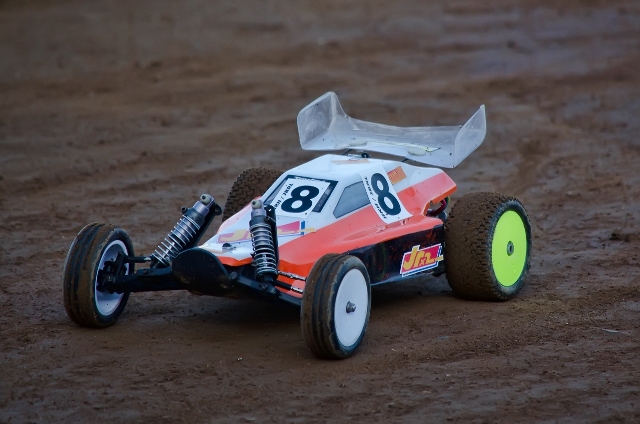

@ the track...

I took it out to my local outdoor track for some running. The little 380 sized brushless system is just amazing, so fast and easy to drive.
The car was jumping really odd and I wasnt happy with the way the car was handling, so I put the 5 link back on, and BAM....there was the car I know and love. Soooo easy to drive, jumped sooooo much better. Gobs of steering (partially due to poor rear tires) and soaked up the bumps like nobodys business.
The track has a challenging double/double section, the faster 4wd short course trucks can triple/single the area, and for a couple laps in a row, I did the same
. Third attempt ended in disaster, busted the 5 link upright (front triangle portion) and demolished a rear wheel.
I will tear the car down, clean it up and shoot some pictures (after the repair), to show the current state of the car. Some fresh tires are in order, and a complete shock rebuild. They feel okay, but could feel better.
Updates later in the week.

Re: start of my first vintage Losi buggy - Old is New JRX-22
Looking good Joey!! how about some damage pic's also so we can see the weak spot?
