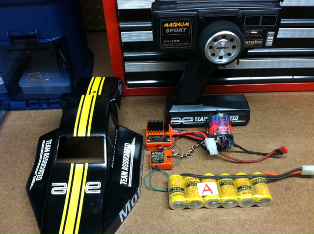

Re: Resurrecting/Modernizing Your Vintage R/C's Electronics
Out with the old......
In with the new.

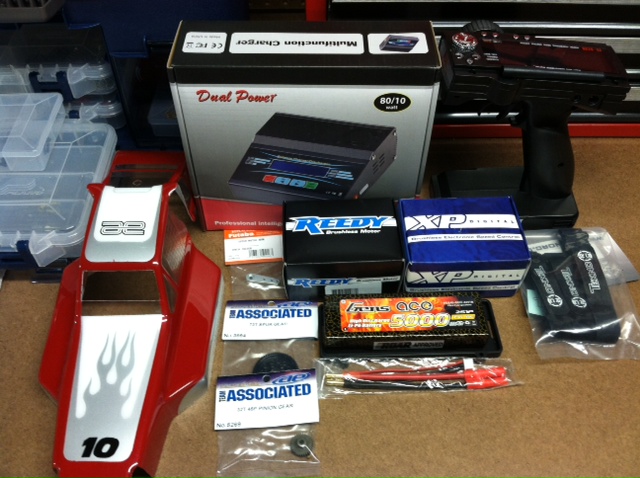

New servo and misc.items on the way/

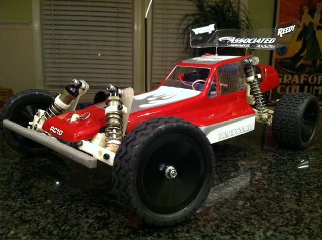

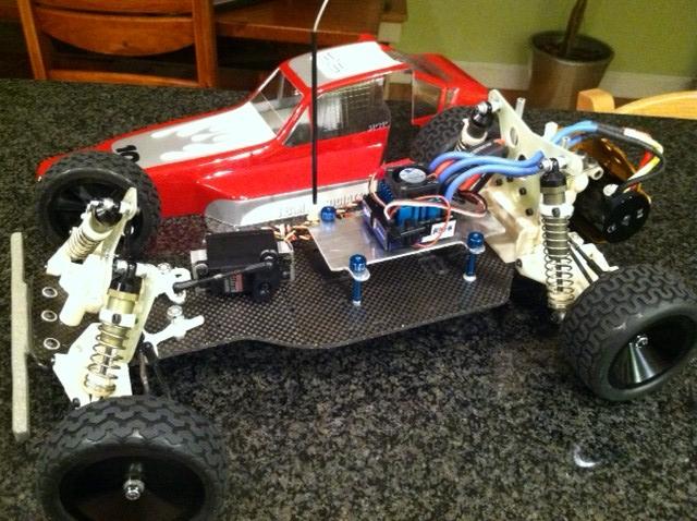

Finally after many hours and many more dollars it's alive. It's sooo much faster than before and I'm still trying to get everything dialed in and figured out. The tires started to wear within 10 min. on the pavement so I put on some old foam onroad tires for testing. I geared it 73/32 and it's really fast but I think maybe too much top end for what I'm going to be using it for. I'm bringing it to an indoor dirt track ( RCexitement.com )Tues and I'll see how she does. I'm thinking of making the upgrades to run modern tires mainly for the selection and ease of getting replacements. Not a big fan of the AE speed control with all the beeps and blinking lights, it's pretty much running as it was set out of the box just because I couldn't figure out how to make changes to it.
