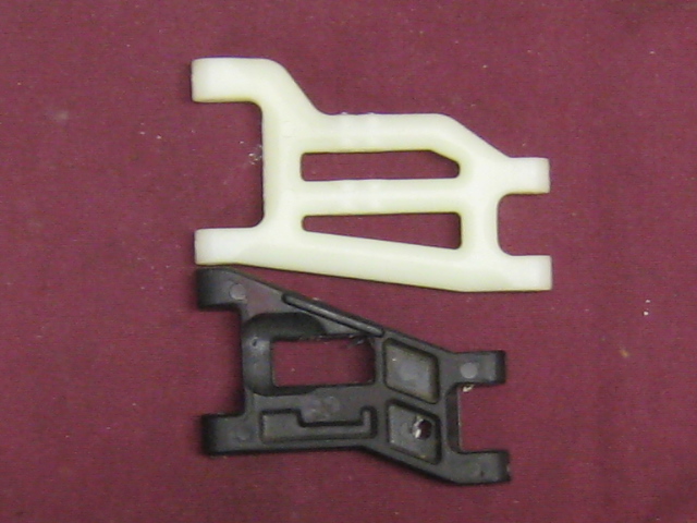

here's some comparison pics. the first one is a worlds arm and a 10t, the second is a worlds arm and a stock rc10 widetrack arm. here's some measurements, too. all of them from center to center at the hinge pin.
rc10 - 2"
worlds - 2 3/8"
rc10t - 3 1/8"
rc10 - 2"
worlds - 2 3/8"
rc10t - 3 1/8"

Anyone got the RPM B3 front arms to measure? They look too wide though...scr8p wrote:rc10 - 2" worlds - 2 3/8" rc10t - 3 1/8"

Well the photos above show that the 10T is the longest then the worlds, then the stock arms. But what I am trying to determine is - Will the RPM Worlds front arms work with the RPM Team Rear or is there a special RPM Worlds Rear that matches the front. I dont want to look around all over for a worlds front end if once installed it makes the front wider than the rear... To me, it looks like I could mount Regular RPM Team front arms and be ok, but I dont have those either. Just trying to figure out what to actually look for and make sure I get the right stuff.

The RPM "World's 91" setup moves both the front and rear inner arm pivot points inwards, retaining the same track width. The arms are longer to compensate for moving the front (via a 10T bulkhead and noseplate [on an alloy chassis]) and rear (via narrowing the chassis via the template and special rear arm mounts). The rear is also "supposed" to use different hub carriers, but stock 10T (or "regular") ones work fine.
