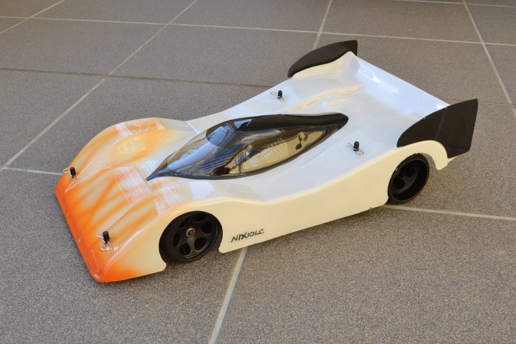

Like I mentioned earlier, the only reason for making this NIX car was to get a RC10LC size Runner. And one for my friend as well.
Let the original RC10LC's be on the shelf. Running those was little too scary.

what an awesome job! that whole project turned out amazing! what body is that? It looks killer in orange and black.

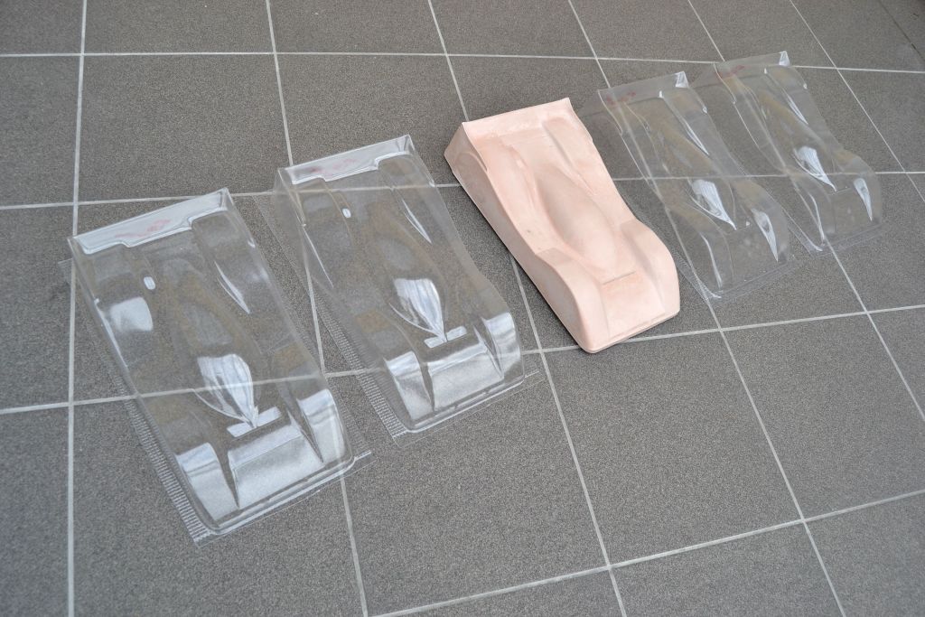

Re: RC10LC - IFMAR 1996 On-Road Worlds Special
Thanks.
It's a copy of prototype body #6139 Nissan 96 GTP.
One original can be seen in the first photo of this topic.
I made a plaster cast of it and vacuum formed a few bodies out of PETG.
-N-
Testing my new mold. Works nicely.

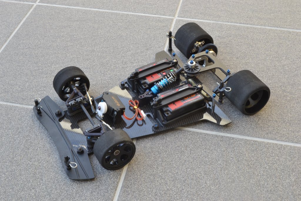

NIX car is now equipped with B44.2 battery cradle. Perfect fit. No more struggle with tape.
Car is now sold to my friend so I have to build a new car. Wonder what it would look like...
-Niki-
Now it's ready for coming indoor season. My friend is going to have it tomorrow. I'm sure he likes it

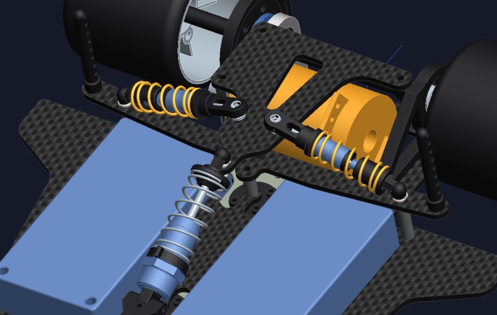

NIX10LC Evo2 rear end will look something like this...
I think there is going to be more than enough suspension options when making the rear like this:
T-bar loose/side shocks with springs
T-bar spring/side shocks without springs
T-bar spring/tubes instead of shocks
-Niki-
