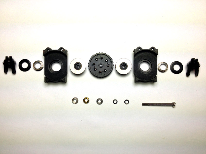

Front Gearbox breakdown and surprise surprise, its nothing like what is displayed in the manual. The only thing I have to find are the (T029 T515) plastic cups for the one way roller bearings.
So it looks like as if this car is actually an XL/XLS hash job...... not very happy!

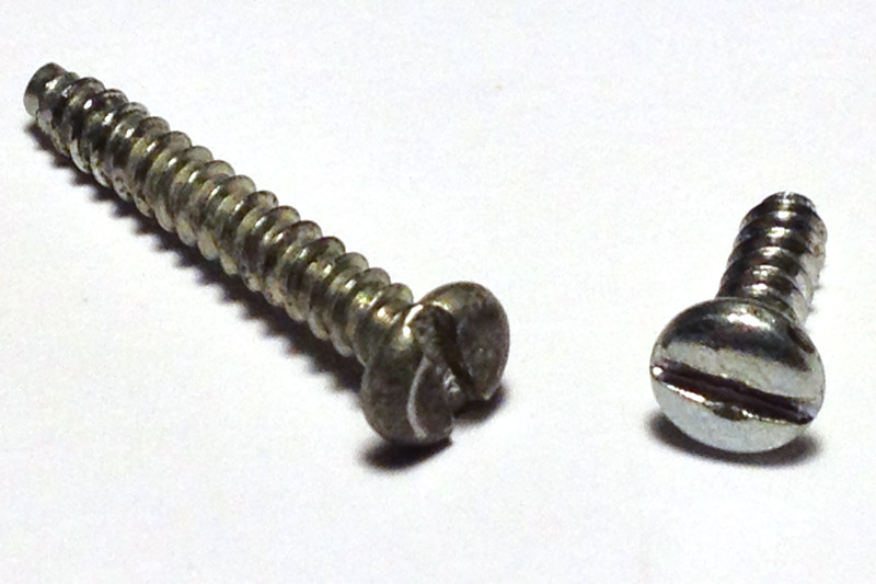

The hardest thing to find, or at least I'm having trouble sourcing are the original style of stainless steel pan head screws, surely someone must still make them. I just need a big box of various sizes.
Jay Dub
Posts: 1136
Location: San Jose, Ca.
Re: CAT XL
Post by Jay Dub »
They are not stainless btw, just plated steel.

Neils74 wrote:Front Gearbox breakdown and surprise surprise, its nothing like what is displayed in the manual. The only thing I have to find are the (T029 T515) plastic cups for the one way roller bearings.
It's not so bad, yours just has an optional diff up front rather than the spool. I think all the mods add to its charm :)
Paul.
Paul.
Yes I agree... If you think about it - the CAT was a thoroughbred racer, therefore anyone racing this car would be looking to upgrade it as new & improved parts came out... its like now I'm quite interested in getting the new mid motored 2wd Yokomo, but I would be looking to 'upgrade' it straight away with the optional geared differential!
As you are intending to run this car rather than it being a prestine shelf queen, the upgrade diff is a nice bonus IMO :wink:

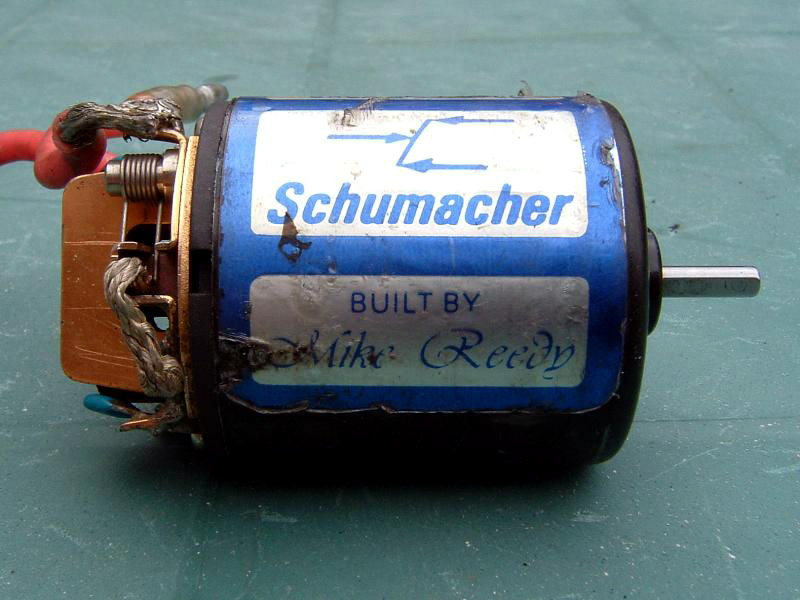

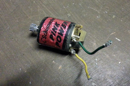

So next on my check list of things to source is the motor.....because I am sure what i have now ( A Trinity Speedworks 350 2 Wheel Drive) will probably destroy the gearbox.
I have found a couple of murmurs on the inter web about Schumacher made motors. Does anyone know anything about them? Are they rare/rubbish/amazing etc?

Jay Dub
Posts: 1136
Re: CAT XL
Post by Jay Dub »
The gearbox properly adjusted can handle more than you might think. And the Speedworks motor you speak of is by no means a "Monster". If anything you might find it underpowered. -Jeff

Jay Dub wrote:The gearbox properly adjusted can handle more than you might think. And the Speedworks motor you speak of is by no means a "Monster". If anything you might find it underpowered. -Jeff
i do hope the 30 year old plastic will hold up!
just found the specs for said motor. Machine wound 18 turn double. Connected up to a battery and wont even spin anyway
If I remember rightly, all the cool kids in school had M.G. Red and Brown dots

Post by CAT3K »
MG motors still turn up fairly regularly on ebay. I used to run Demon motors in my buggies bitd 8)
Paul.

Post by DerbyDan »
Yes Demon, Reedy & the Schumacher modifieds were popular motors at my club when I first started racing in the late 80s. The MG brown dot was a 27t stock motor (not sure what wind the 'red-dot' was) I've got an MG orange dot to go in my TopCat, which was also a 27t stock but was I believe was the wet magnet version... this was the first non Mabuchi/Johnson 540 that I ever ran in my original TopCat.
A 27t stocker is going to feel a little sluggish in the 4wd CAT with its rather complex drive train sapping power.. I reckon a nice 15t triple would be just nice!
Bear in mind that any vintage motor probably won't perform quite as well as when it was new as the magnets do gradually go 'soft' over time :wink:

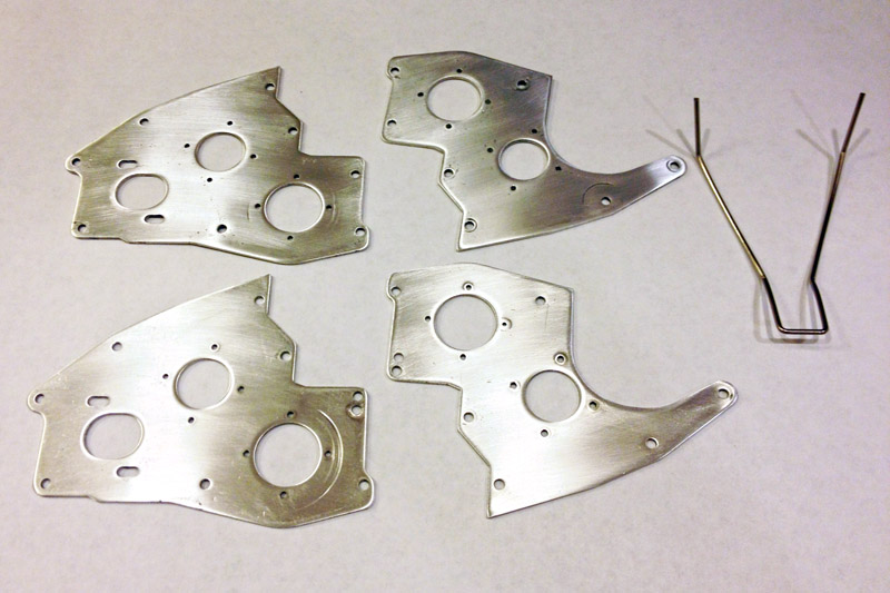

So started cleaning up the motor plate and the cover plate. I was given two sets, both were bent and heavily scored and in fact one set has extra drill holes (not sure why).
I started with 400 grit and then onto 600. When I stop bleeding I will move onto 800 and a little brasso. But so far so good.
I'm sure I am not the first, but do not wet and dry the plates whilst holding them in your bare hands..... yes, the scoring is disappearing, but so has most of my finger tips and palm.
As for the motor, I have managed to purchase a Schumacher pink power for $7 off ebay.... lets hope it works.
