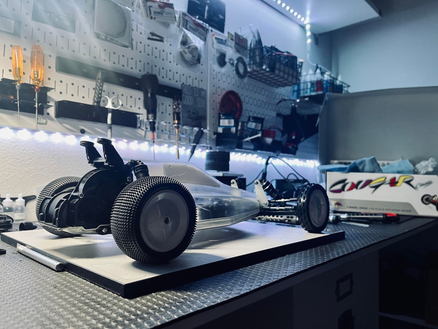

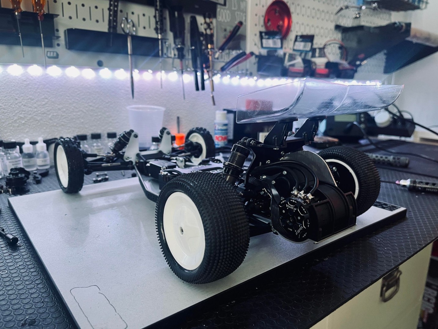

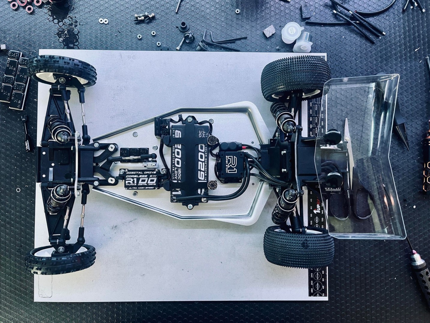

Here it is finished on the bench.

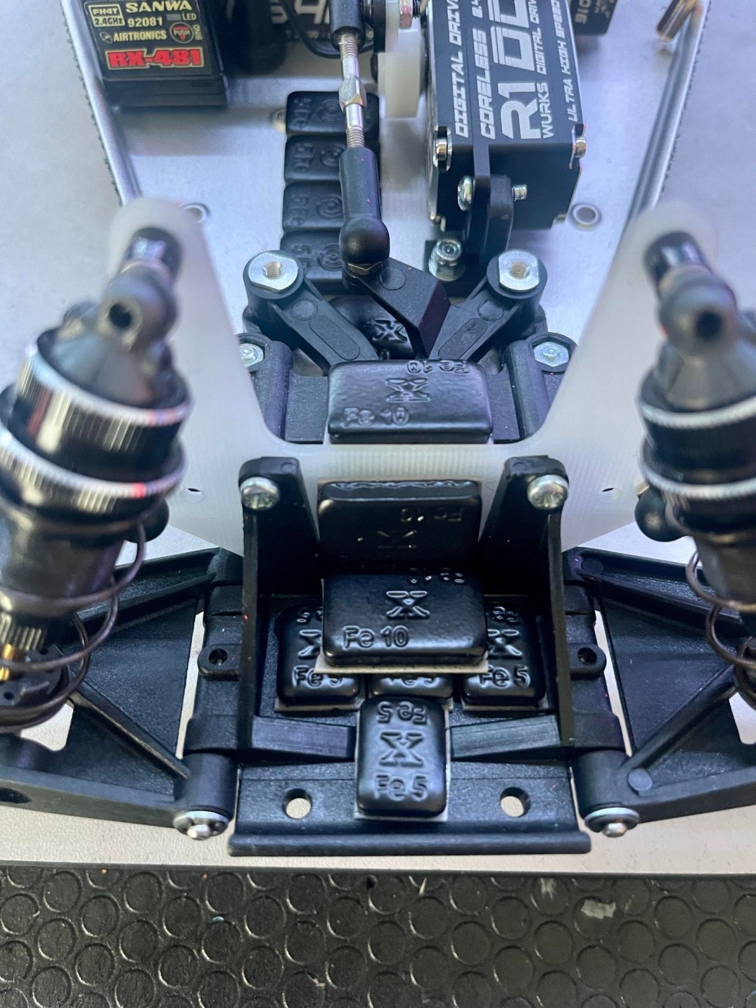

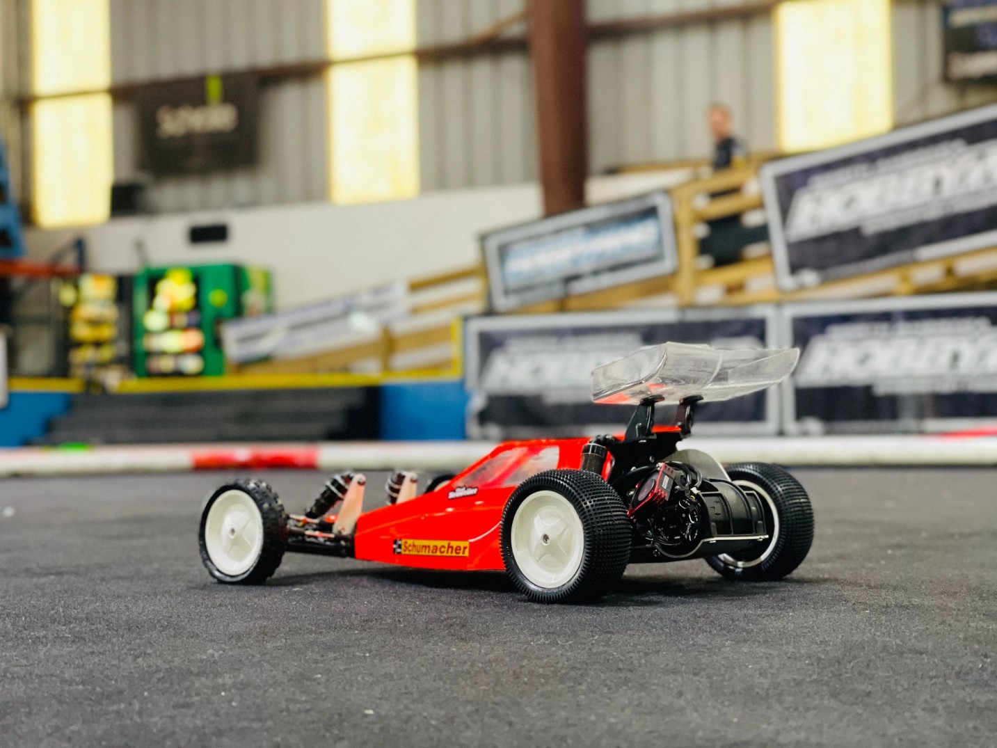

Went to the track and it was incredibly under weight so I had to add a ton of stick on weights. I put them mostly on the front end as I run on black CRC carpet.

The tires are Schumacher Cut Staggers in the front and Cactus in the rear both in yellow compound.
Its going to be a little bit of both. It will mostly sit on the shelf unless I feel like taking it out for some low stress racing. Since I am sponsored by R1 Wurks I outfitted with all R1 goodies and its got a 17.5.
I just painted a quick body for practice but I plan to get a cougar 2 body done up in my racing scheme.
Also the car handled incredibly well! I was so surprised when I took it around the track I find myself ripping pretty much instantly. After about 4 runs the belt started slipping and I couldnt tighten it enough to hold anymore. Black carpet just has too much traction for it. I just came home and installed the pro transmission with the slipper as I figured this would happen and had already purchased one just in case.
Gonna take it back out tomorrow its a blast to drive!

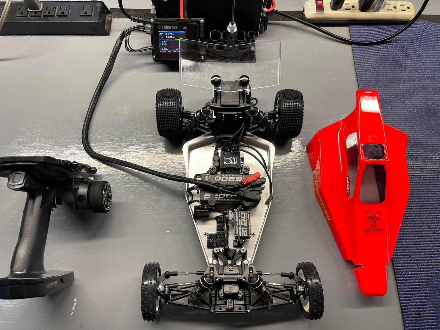

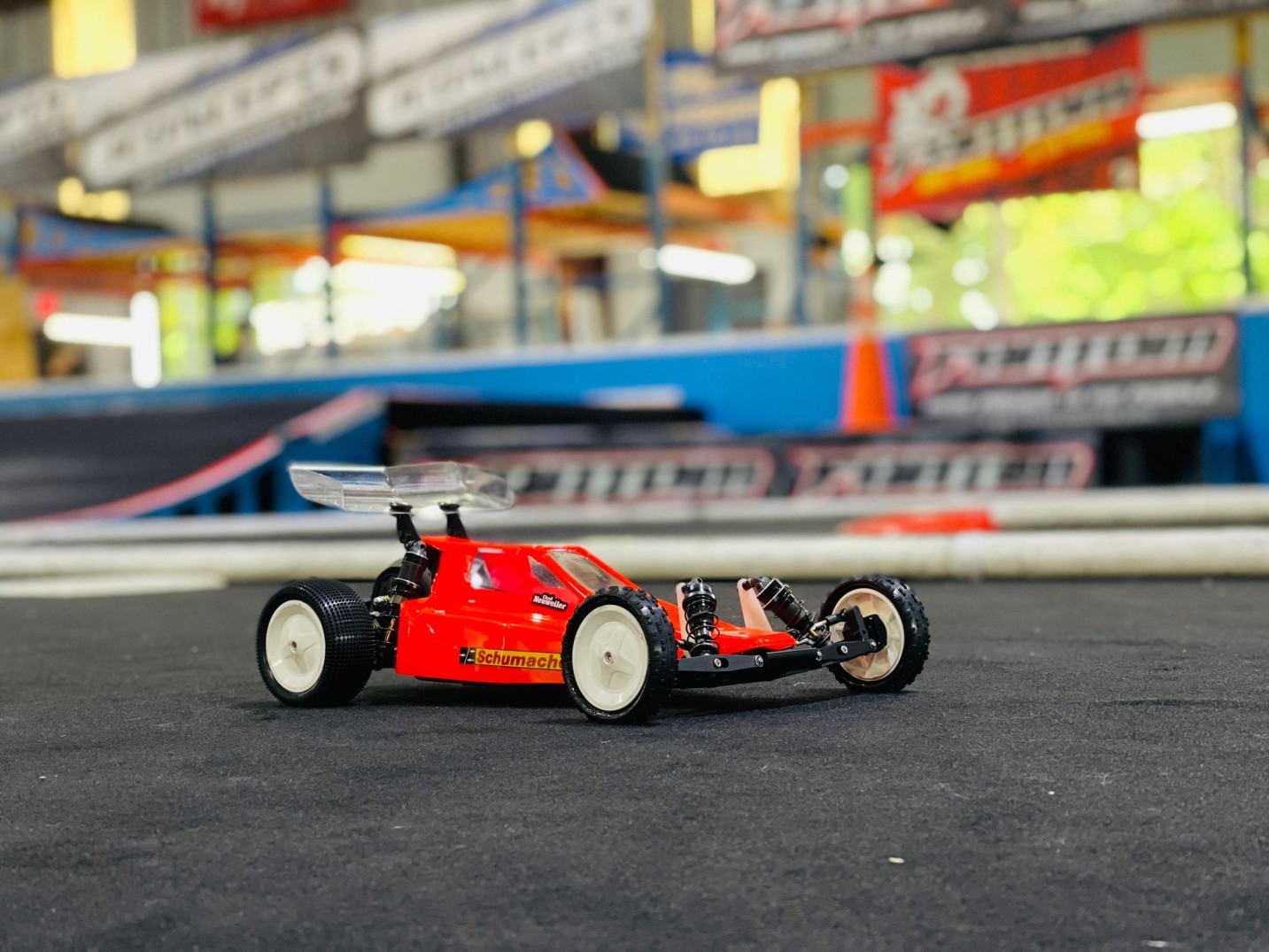

Got my chassis bent by a novice in practice but other wise she survived her first race day.

Very cool must have been a mission gluing those 2.2 tires to the 2” rims.
You’ll pretty much end up locking up the slipper but the 3mm belts are a must on carpet for sure
