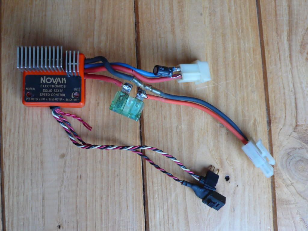

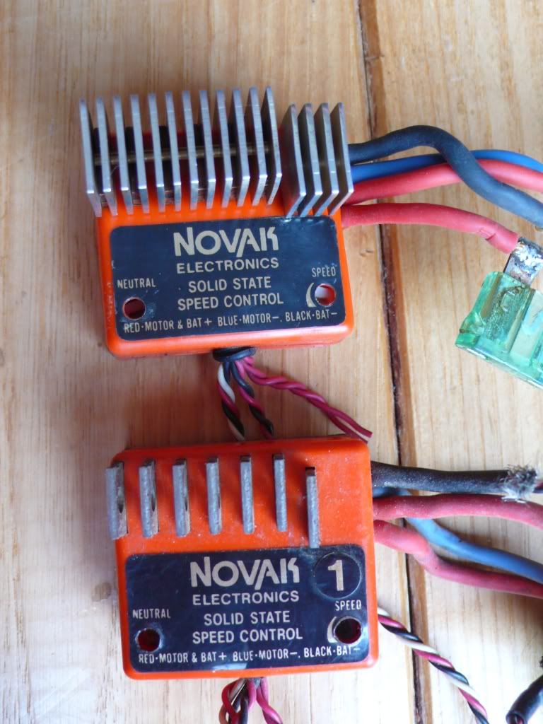

The receiver and ESC lot arrived the other day and I must say I'm very happy with the purchase. The only thing that is complete, in good condition and probably still working is precisely that very first Novak ESC that, by the way, still doesn't appear on Novak's web site timeline though I think Tadracket sent them pictures of the one he had. This one is the in fact second one I've ever seen in more than 6 years of part hunting so I guess they quickly switched to the Novak 1.
Here it is partially cleaned; I will open it later on to eliminate every bit of vintage dust, glue and dirt.

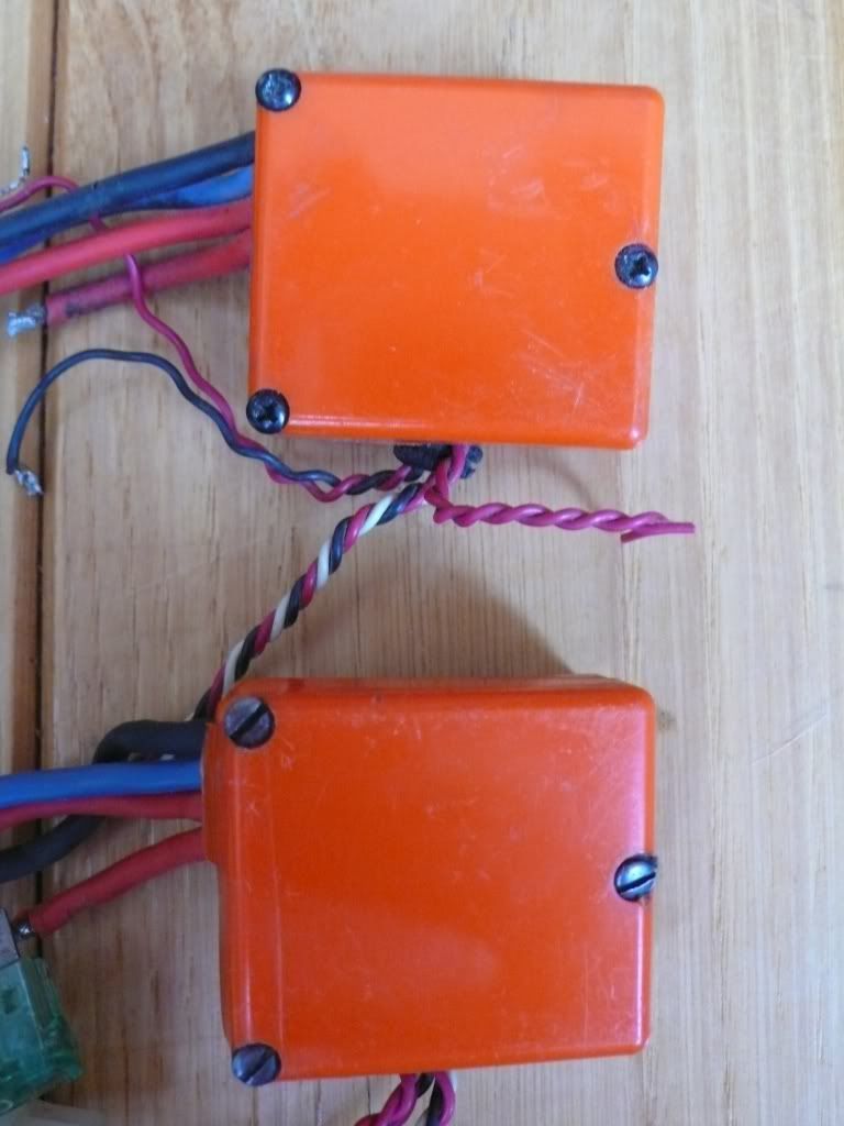

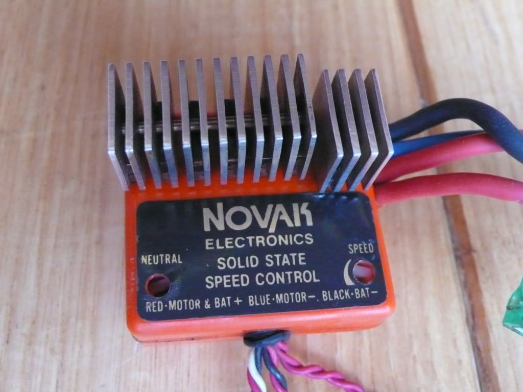

I also noticed a few differences between the "box-art" ESC and the Novak "number 1":
Let's first have a look at the external aspects. While the "box-art" one has no number, the Novak 1 has a sticker on it and is fitted with black anodized heat sinks while the "box-art" one has silver ones with light touches of gold ano (pretty obvious so far)

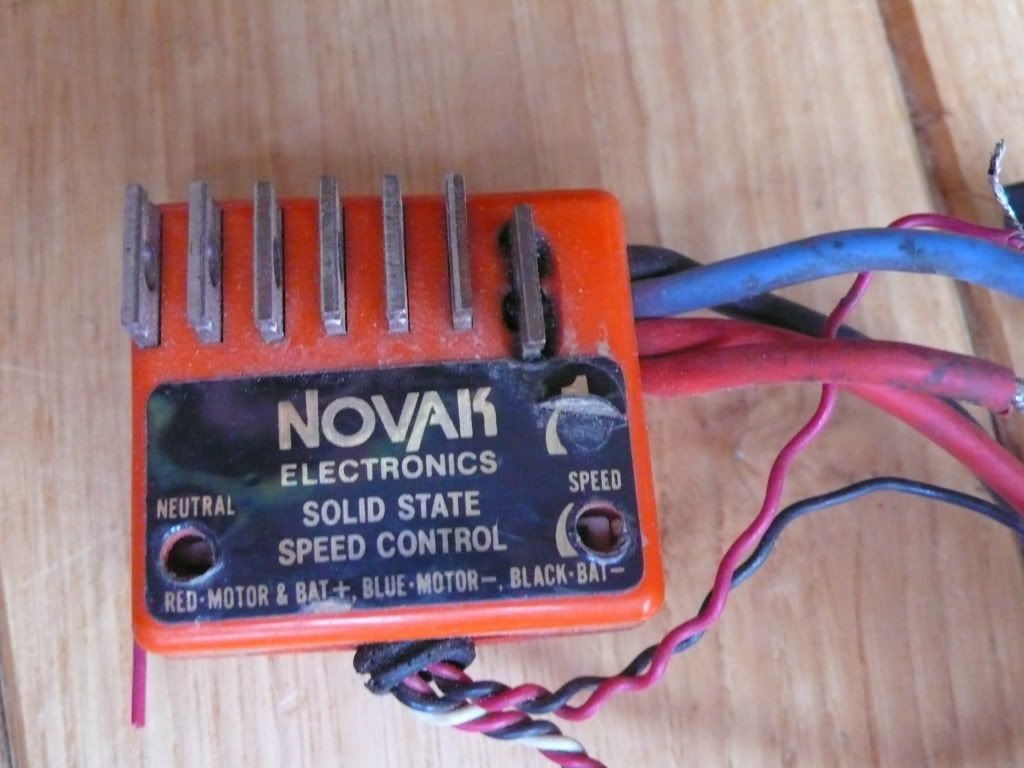

Now some of you may smartly think "ok, I'll just find a Novak 1, peel that sticker off and dip the heat sinks into oven cleaner and call it a day", but that will not do...

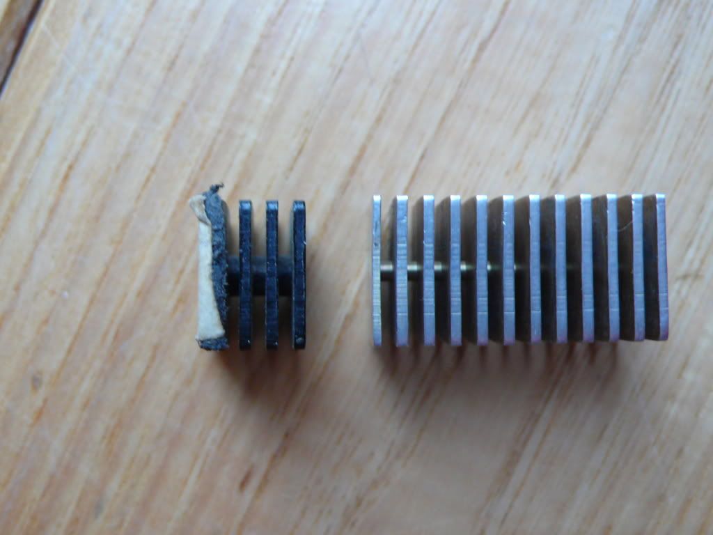

Indeed, try to peel the Novak 1 sticker and this is what you will find underneath:
What is more, the heat sinks also show a main difference: the central bar that holds the fins together on the "box-art" ESC has a smaller OD than the later black heat sinks:

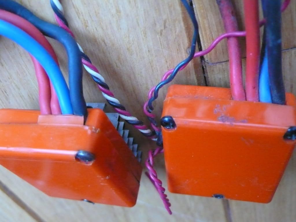

Finally, while the orange plastic cases appear to be the same at first glance, here as well we can note two main differences: the "box-art" ESC has slotted screw heads while the Novak 1 has Philips screw heads and the slot for the wires on the "box-art" one is not totally trimmed compared to the Novak 1:
Sorry if I may look like a scrutinizer :oops: but I think this is part of the R/C history and just wanted to share the info. I hope you enjoyed it!

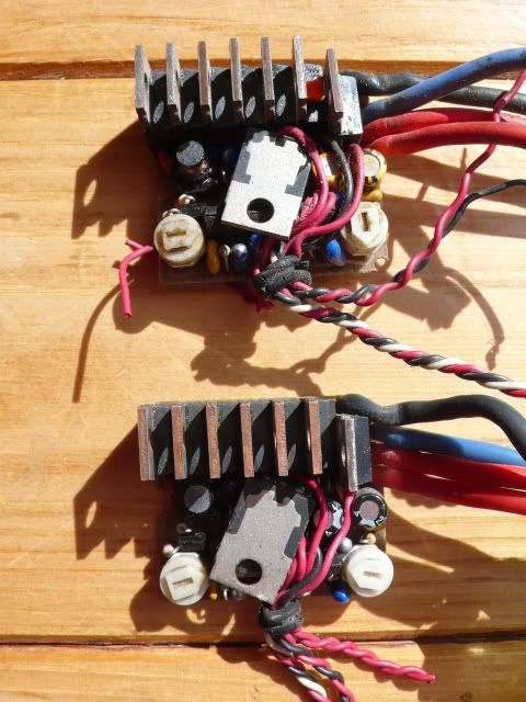

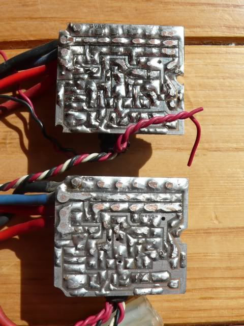

Let's also have a look at the inside, the top one is the "box-art" ESC in both pictures. Both circuits appear to be exactly the same, while some components show some slight color differences... It would be nice if a old Novak dude could tell us the real differences. I may send them an email with pictures so that they could upload them on their timeline and maybe learn a bit more about the quick production changes.
