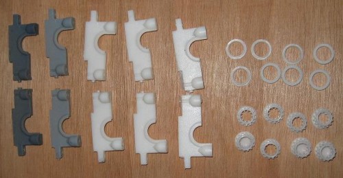

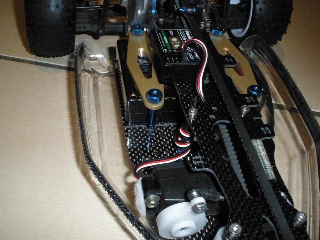

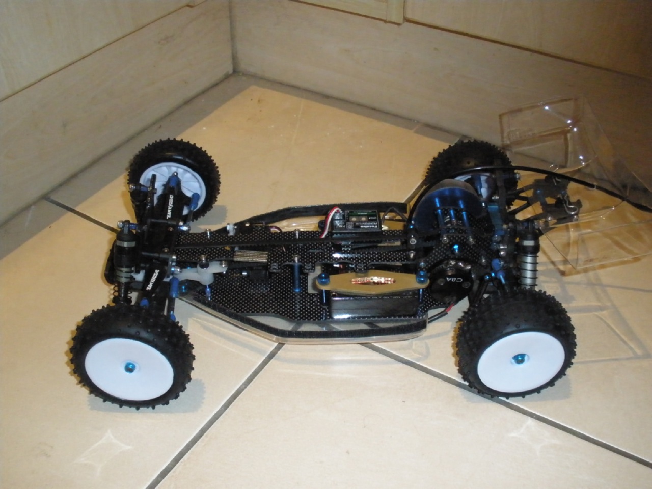

Guys,
Work has been done since I last posted on here. I have put wider front hexes on the front and narrower on the rear and added Annsman 2wd Mad Rat wheels front and rear.
I have also got a proto layshaft gear LA11 which has worked fine so far. I have also designed LIPO trays and fitted to the car. Brass ones will follow soon, with hopefully if they can make it a brass rear top deck holder.
Diff gears are being molded now and will use smaller diff balls and will have more holes making the diff ultra smooth and making the diff so much easier to use and work with.
I am also going to be working on a servo saver design on the blue steering section, which are white on my car at the moment. This will make life easier if this is in the car rather than using a Kimbrough.
Then I am also awaiting a mold for the spur gear to be made with ball holes so I can use a ZX slipper, as I believe with a reverse one way this will be the same as a normal slipper but better as it will not burn out due to the metal balls and metal plates on the spur section. If this works I will finally be able to use a 5.5 without the car wheelying all the time.
