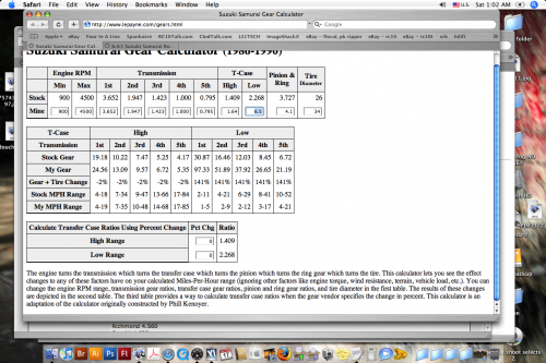

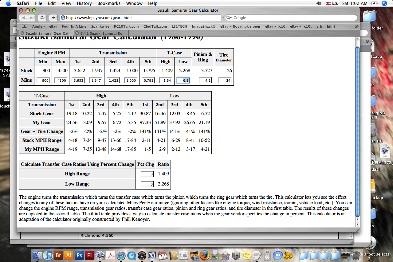

Be careful of going that low in the t-case, it will put alot of stress on your driveshafts , u joints and pinion. You must change the mount for the case, plus I have heard it will hum at speed. Gearsets are cheap and puts the reduction closer to the wheels. The t-case kits look like a easy way to go, but not always the best.

i got a transfer case bucket coming with the transfer case, i dont read alot about guys breaking toy stuff under samurais. really the only thing i'm worried about is ripping the frame, and i'll prolly end up using stock rubber mounts and just keep some spares. its not like i'm some hardcore dude anyway, i'll prolly wheel it 4-5 times tops this summer.
the orig owner had a 4:16.1 transfer case in it, and i'm sure it did fine, but i got a smoking deal on the 6.5. and the 6.5 and 4.11 gears its easier for me to get a good low ratio while keeping some highway drivability. (only a 2% change from stock in 2h) and those toy diffs have aussie lockers f&r as well. i dont really want to mess with them if i dont have to.
