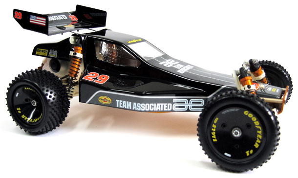

Having an issue with the right side cva. Doesn't sit in the cup far enough, and when testing, popped out of the cup twice. The left side is a good 2mm further in the cup and seats nicely, but the right side does not. This only happens when coming up to more than half speed on the road.
Anyone got any ideas? Are the cva bones that are just a smidge longer that I can use?
vintage AE
Posts: 3012
Has thanked: 29 times
Been thanked: 36 times
Re: TC's RC10 Project X (closer to the finish now with pics)
Post by vintage AE »
Are you using the B44 front CVAs?
Check the amount of axle shims you are using on both the inside and outside of both left and right axles. Maybe you have one cva set further out than the other.
it's hard to tell from your pics, but make sure you have the rear arm mount on the chassis correctly. left on left, right on right, and the letters facing down. something just looks wrong back there. your ride height looks awfully high as well. add a spacer or 2 to the inside of the shock so that with the shock fully extended, there's no way for the bone to pop out.

scr8p wrote:it's hard to tell from your pics, but make sure you have the rear arm mount on the chassis correctly. left on left, right on right, and the letters facing down. something just looks wrong back there.
I think the arm mounts are on the wrong sides. When I got back into RCs recently, I got them backwards, I kept on facing the car towards me and thinking the left was on my left, oops :oops: :lol:

Ok, I am using the rears. Switched some things around, and hot dang, that thing is flying. Intill someting popped in the tranny. So how do you rebuild a vintage stealth to handle a 4900 motor?
Editted to add: It was NOT the trany, it was the pin in the cvd. Just have to get a new pin.....

Just took apart the rear end, you guys were right, I had the mounts on the wrong side.....
