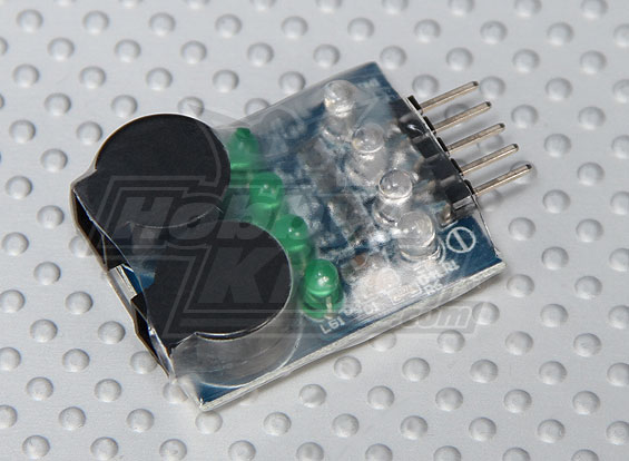

I drop the idea of waterproofing the ESC using the plasti dip or silicon.
If someone is going to this route do not use Tamiya's esc for some reason.
Aside for waterproofing issue this ESc do not have a lipo cut off which is not good for the safety of the lipo.
To protect my lipo battery I ordered a Board Lipoly Low Voltage Alarm
Which will alarm loudly and the LED will change from Green to Red if any individual cell drops to 3.3v or below.

The LIPO Battery
The Battery arrive and the Lipo Voltage Alarm :D
