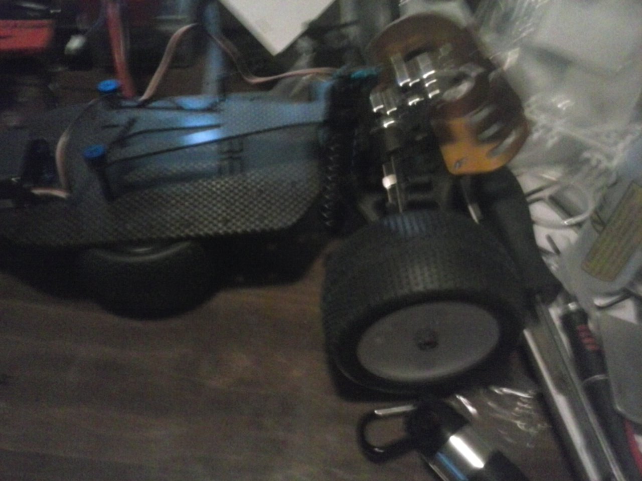

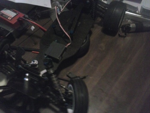

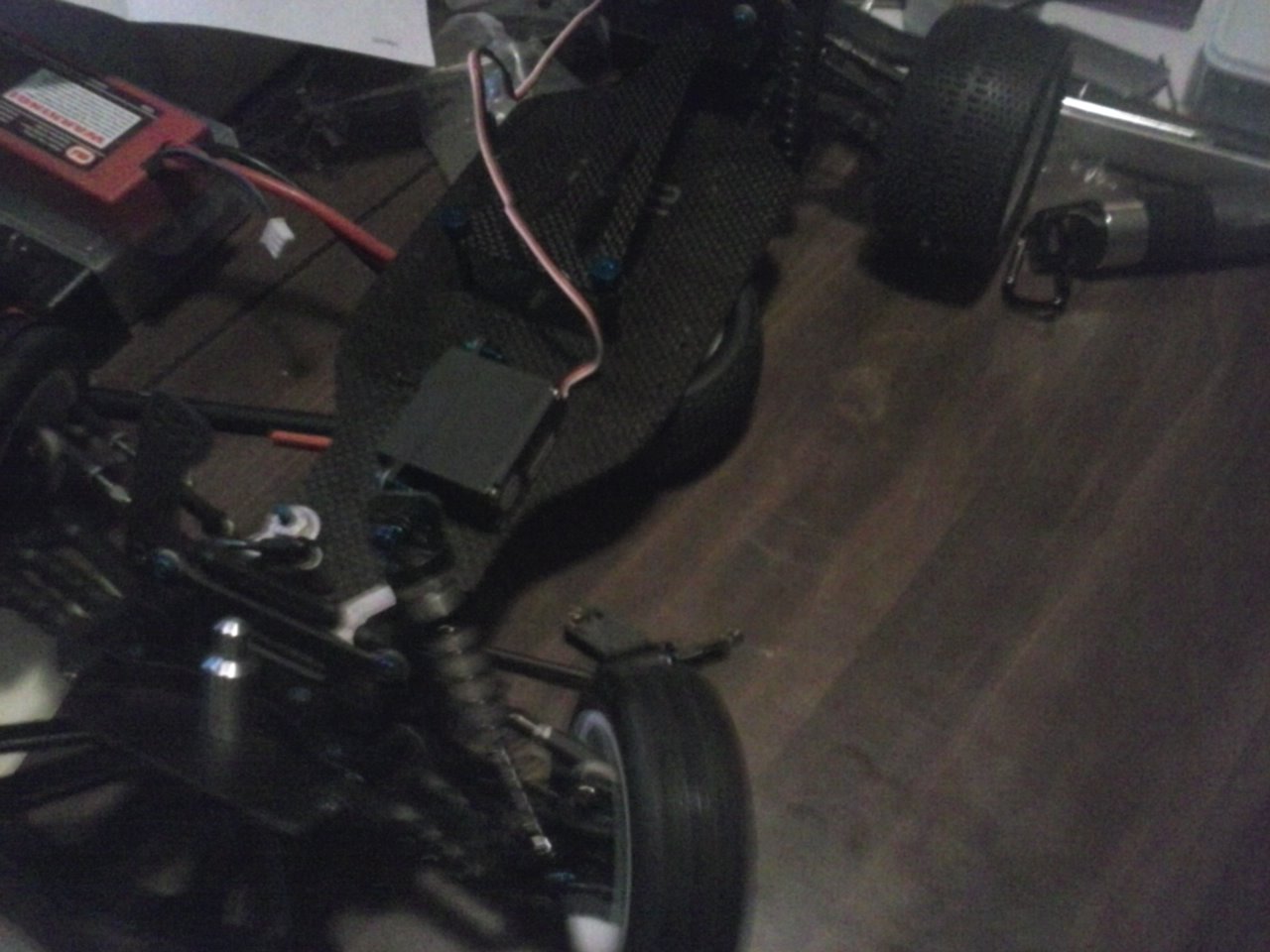

Ok so I had to modify a few thing
like the b4 hubs they were causing the axle to bottom out in the drive hubs so I used a 3/8 reamer and by hand I renamed the hole from the back wide deeper to allow the bear to sit down in the hub more.after that I used the drill press to open up the hole to allow the cva to go down more and using axle spacer to take up the slack(a lot) to hold the blue wheel spacer up to the pin.I also used the 1/8 space to allow more spacing.
I also used the b4 shocks so since I am not a big fan of the blue body that uses clips I got threaded bodies and used the b4 shafts and caps.
