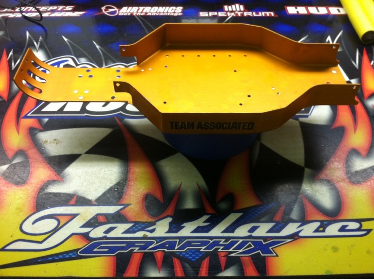

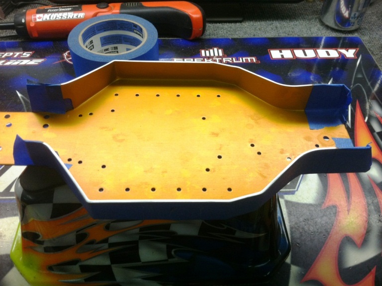

Got this baby in the mail the other day. Was thinking about cutting the chassis sides down like the original Halsey Car. What do you guys think? Cut or no cut? :roll:
Kooz
askbob
Posts: 1736
Location: KY
Re: Jay Halsey 85 Worlds Build
Post by askbob »
Depends. How well do you trust your dremel skills? :mrgreen:

askbob wrote:Depends. How well do you trust your dremel skills? :mrgreen:
I actually got a chance to test them out on my son's Pinwood Derby car yesterday. :lol: Gotta say.... not bad! LOL

You have to cut it to make a JJH copy! :wink:
Posts: 16816
doing a nice job cutting out the nose plate is a lot harder than the tub sides. :wink:

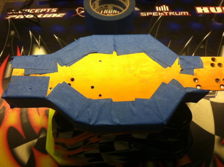

Just to be safe mask it off with duct tape (maybe even a double layer) around the cut lines so that if you slip you don't do an ouwie to the base of the chassis.

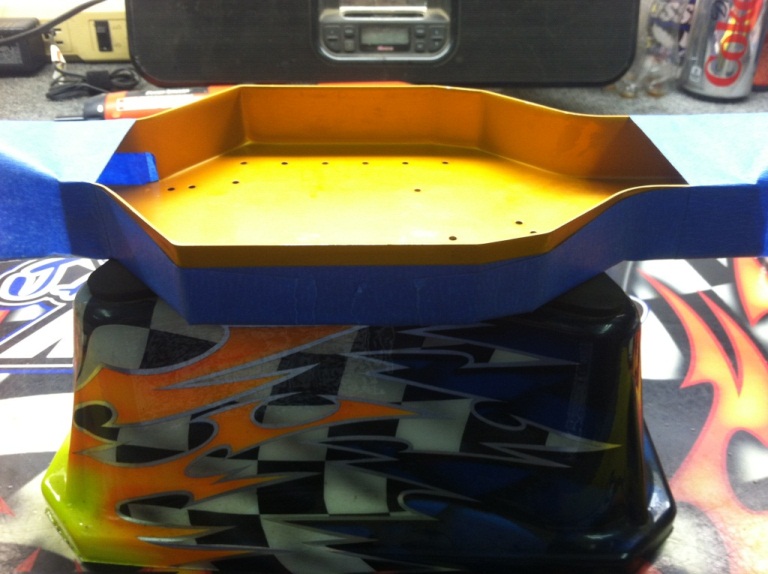

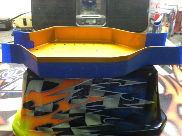

Finally got around to finishing the chassis mods last night....
Pre surgery!
Pre surgery!
One side done and transfering cut lines!
2 layers of masking tape just in case!
Masking complete! Time to cut!

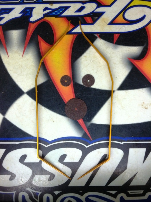

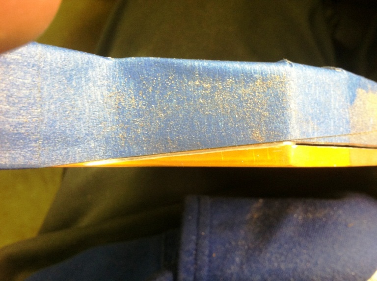

Found it easier to score the edge first with the dremel cutting wheel. After that just made even passes along that score.
Freshly cut / pre-filing & sanding
Tapered rear motor guard mod.
What was left after surgery! LOL
Kooz
