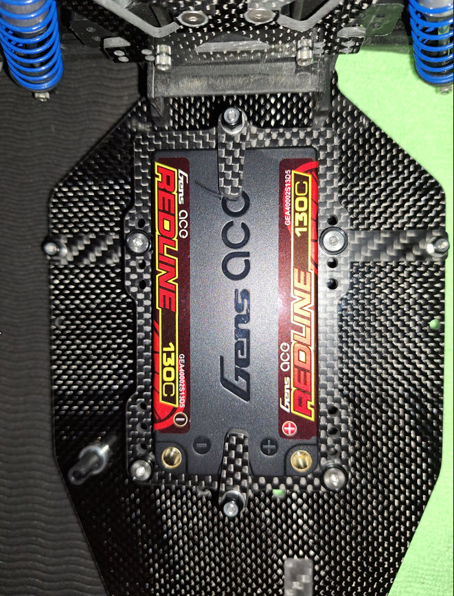

Playing around with fitting a battery LiPo cradle, Sussed out the pair of rearward holes for the battery clamp aligned with the spacing for the cradle,
So i cut some carbon and made a strap across between the tailing arm mounting holes. (not used on the Pro)
And drilled/countersunk some M3 screws up to give a second mounting point.
used some 10mm and 12mm alloy spacers to level out the cradle, and will add some foams to even it out.

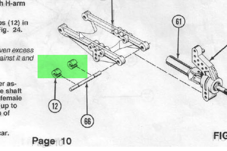

been having a few problems with the Rear hub pivot pins,
Only found one of the 4 required plastic "C" clips to hold the pin in the right place.
With age and wear those pins were trying to slide out on their own, without anything better to use, and trying to source those clips was not easy.
I had a bag of 316 control arm locators for Aircraft servo applications, obviously designed to have piano wire run through them and nipped down by the grub screw and attached to the servo horn via the M3 thread and nut.
The Bore was 1/8" (3.18mm) so i cut the stubs and threads off, smoothed off the face with the Dremel, and redrilled the holes 2.5mm, threaded to M3,
so a 6mm spacer I can nip up tight with 2 grub screws and loktite.
Tried using E clips, but just kept coming away. Used an alloy spacer on the other side, its M4 rather tham M3 but i had it handy,gets the job done and wont fall off
