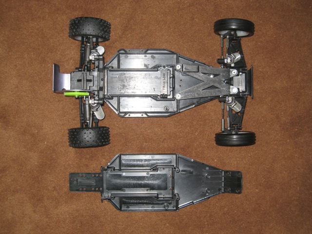

- bearrickster
- Posts: 4372
- Been thanked: 8 times
Re: JRX Pro chassis
Highwayracer (or anyone else),
Can you tell me which chassis I have? I know what they are "supposed" to be, but I want to check.....
Thanks!
Thanks!
highwayracer wrote:Technically, it's the medium chassis in the jr series. Let me explain
jrx2 - short graphite chassis (curved edge near the front...20 degree kick)
jrx pro & jrxt - medium graphite chassis (straight edges all around...30 degree kick)
junior 2 & junior t - medium wide composite chassis (same holes as the medium graphite chassis)
jrx pro SE - long narrow composite chassis, but uses the shorter set of rear mounting holes
lxt - long narrow composite chassis, but uses the longer set of of rear mounting holes
hope this helps...rather than confuses...
regards,
highwayracer
- bearrickster
- Posts: 4372
Re: JRX Pro chassis

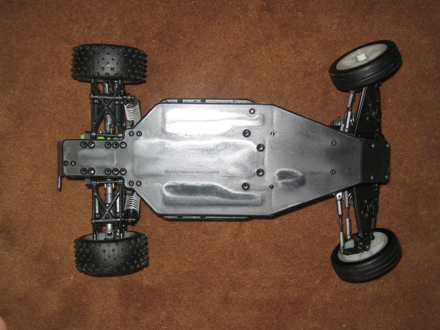

the complete car is a Junior Two or Junior T chassis and the bottom one is a Jrx pro se or LXT truck chassis. If you want to get ride of the striped pro chassis I would be very interested let me know Rick.
- highwayracer
- Posts: 1187
- Location: Illinois, USA
- Been thanked: 6 times
Re: JRX Pro chassis
oldskool,
Rick is correct, in the first picture, the top chassis is the junior 2/t chassis. The one on the bottom is the pro SE / LXT chassis (you can see the second set of mounting holes for the longer wheelbase). Both chassis use the same top plate. The SE / LXT chassis uses a foam insert that sticks in the center section in the battery compartment.
Your second picture threw me off for a second. I was seeing an SE type chassis with the 5 link holes...until I noticed that you just placed the chassis on top of the other car
regards,
highwayracer
regards,
highwayracer
