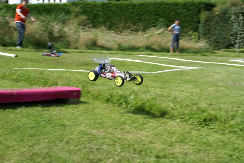

Thanks Jason, honestly the car was doing superbly, I think it is a lot more stable in the straight lines and corners and it jumps really awesome (see last picture), the only drawback compared to a modern B4 is the understeering, but it was not such a big deal on our grass track with plenty of grip. I was also afraid of breaking a dogbone because the RPM arms twist really easily (which is good from a breakage/shock absorbing point of view) and allow the dogbones to touch the outdrives on big shocks. After 6 hours, there were some scars on the bones, but nothing broke. I think that it could be fixed with using the RC10 GT RPM rear hubs and a different anchorage of the rear turnbuckles on the shock tower. I don't want to race my B4 anymore :!: I must also say that the Mamba brushless set-up is really awesome and so cheap compared to the Novak/LRP ones. They are legal in Europe (EFRA), but not in the US (ROAR) unfortunately...
