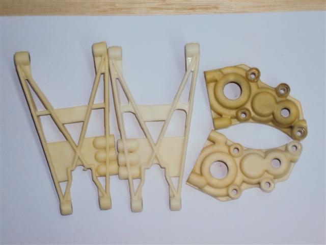

the first parts i started with after about 52 hours in a 3% solution using uv lights. as you can tell it does not make the parts look new but it does make a big difference. also note that all the parts were thoroughly cleaned before any part made it in the peroxide bath. so the dark parts are what the parts look like after they are cleaned and before the peroxide. and the parts were the exact same shade before the peroxide.
now i wont be tearing down all my cars to do this but i will continue to play around with using the peroxide for a while.

Wow that looks good. I wonder if you added some bleach white or simple green to the peroxide would help or hurt?

LowClassCC
Posts: 935
Location: Mauckport, Indiana
Has thanked: 108 times
Been thanked: 171 times
Re: Anyone tried this? Yellowed parts white
Post by LowClassCC »
the cleaner i cleaned the parts with before i started was lysol bathroom and kitchen cleaner. i have used simple green and i tried the lysol one day when there was no simple green in the house. since then i haven't looked back.
i have also tried bleaching parts with bleach. it did not make the parts any whiter than they already were after cleaning.
i wouldn't bother with the bleach. but if anyone does try it just think about what bleach would do to your clothing if you has your clothes soaking in it for hours. now hydrogen peroxide on the other hand is drinkable. so other than short exposure to a harsh chemical i like using stuff a bit safer.
simple green has dye in it to give it the green color. when trying to bleach something i feel its best done with no dye in the mix. that's just a personal preference though and i am basing it purely on my opinion.
