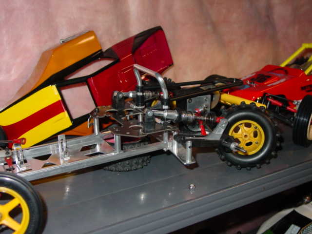

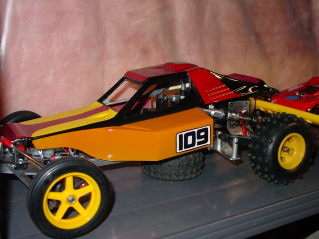

Re: Will These Wheels fit? AYK/Kyosho
It actually is a little bit of a mismatch of parts, but for this build I didn't want to put back on the standard rims. I just happen to have nib Assault rims and they fit perfect. I like the look of the front five spoke wheel. I just transferred over the ayk tires. Then used a optima body and the bright colors seem to go well together.
Brandon.
Brandon.
